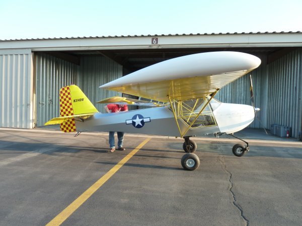

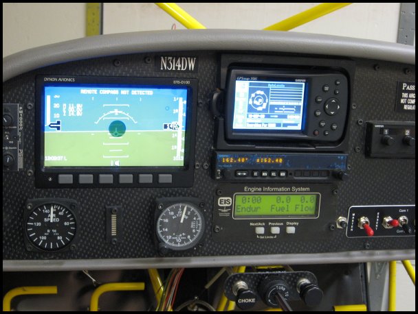

Pictures attached...also this You Tube flic http://www.youtube.com/watch?feature=player_embedded&v=acVvjlwjy5g
