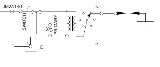

The schematic of this arrangement is shown here:
[img]cid:.0[/img]
As long as the points are closed, a dead short
exists across the primary winding and the rate of
rise of magnetic flux within the core is retarded.
As the points open, that retarding force is suddenly
removed allowing the high voltage to be generated
and distributed to the appropriate plug. Setting
the position of this 'opening event' with respect
to crankshaft and piston position is accomplished
in a "timing procedure".
The primary winding has VERY low dc resistance.
So when you measure the resistance on a magneto's
p-lead to ground, it is difficult if not impossible
to detect when the points open as the shaft is
rotated.
This is why magneto "timing lights" have little
buzzers or electronic oscillators inside to generate
an AC excitation signal which sees a much larger
AC impedance jump as the points open.
http://tinyurl.com/6ttzr94
Shower-of-Sparks ignition systems excite the primary
still more strongly and repetitively during cranking
to generate a stream of sparks when the points open.
http://www.aeroelectric.com/articles/Shower-of-Sparks/ShowerOfSparks.pdf
But unless your measurement system for resistance has
resolution in the milliohms range . . . like this
one . . .
http://tinyurl.com/6o5kqub
You won't be able to use an ohmmeter to either measure
the primary coil resistance -OR- detect a open/close
event on the magneto's points.
