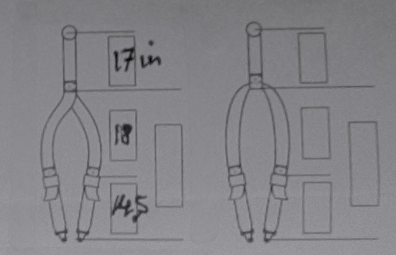

And here is one more questions, I measured the different length of the shoulder harness (see attached picture) I was wondering if this is matching your length.
Especially the first section which attaches to the cabin top which I measured as 17 inches.
Appreciate your feedback
Mike

Sorry to bring this thread up again but I really need to know what the length, especially of the top part of the harness needs to be. Is 17 inch a correct assumption?
Mike

There is an adjustment buckle near the attachment point. Adjust them to suit, and if there is too much tag end, get an upholstery shop to cut it off and restitch a new tag end.
John
