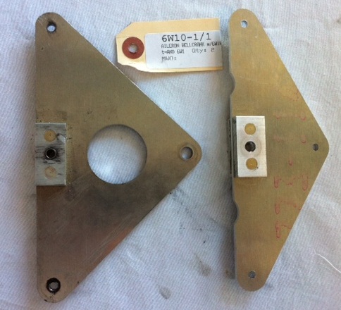

Chris,
The only part information I can tell you is from my actual hardware. the new 6W10‐1/1 bellcrank as compared to the original 6W10-1 moved the distance from pivot hole to the aileron rod end hole from 85 to 48mm. There is no lightening hole and they scalloped the edge of the bellcrank where it comes close to the rib for extra clearance. I do not have, nor have seen any actual drawings. See attached picture for a part comparison.
Hope this helps,

Chris,
Hope this helps,
