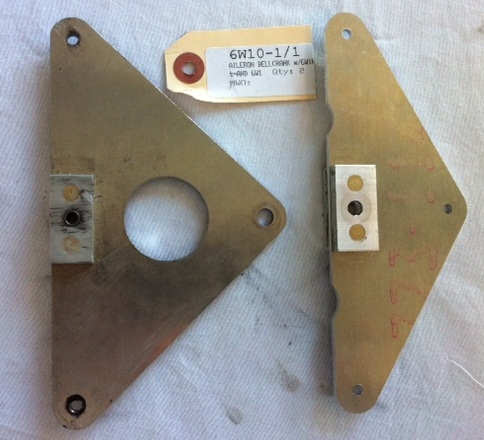

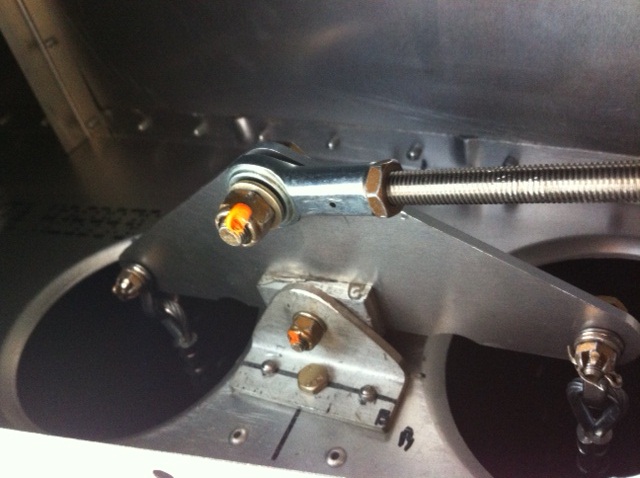

Guys,
I changed my mind. A few weeks back there was the thread about the new aileron bellcrank introduced by Zenith for the 601XL/650. The intent was to better balance heavy aileron forces with the much lighter elevator forces. If you recall, I stated that I decided not to incorporate the change in my 601XL. At Sun-N-Fun I spoke to Caleb about the control stick forces in general by the end of our discussion, I decided I would try the new bellcrank. I could have made the new part myself, but I decided to be lazy and I bought them from Zenith (P/N 6W10-1/1). The new bellcrank has a shorter distance from the pivot point to the aileron push rod.
The replacement took me about two hours and a few drops of blood. Working up in the access hole was a pain, but the job was not too difficult. When I completed the swap, I did not even have to re-size the length of the push rod to the aileron.
After securing everything and ensuring control system continuity, I went up for a short flight. I was quite pleased with the new aileron response. All I wanted to do was rock the wings because it is so much easier to move the ailerons. Based on my experience, I now endorse the new bellcrank. Here are a few pictures:

PostPosted: Sat Apr 07, 2012 7:01 pm    Post subject: Control Balance (Cont.) Reply with quote
David,
Do you have hinged or hinge-less ailerons?

Thanks for pointing out my omission. I have the flex, or hingeless ailerons. This is the worse case that would benefit the most from the new bellcrank.

Moving the hole closer to the pivot increases leverage; more stick movement per degree of aileron deflection equals more leverage.
To be redundant. the changes to the control horn should a: require more stick movement for the same amount of aileron deflection, b: decrease the amount of force required to move the stick.
To be doubly redundant.
So if you like or require less left/right stick movement with higher forces required, don't make the change. If you think you are working too hard moving the stick left/right and you have clearance on all parts of the system, then this change makes good sense.
Ron

Can you be more specific about your left to right drastically reduced stick movement. I have a 601XL-B finished and flying. I do not have any reduction in the left to right control stick movement.
Mostly I noticed some additional inertia in the ailerons due to the increase in mass from balancing the control. Otherwise it flies the same.
