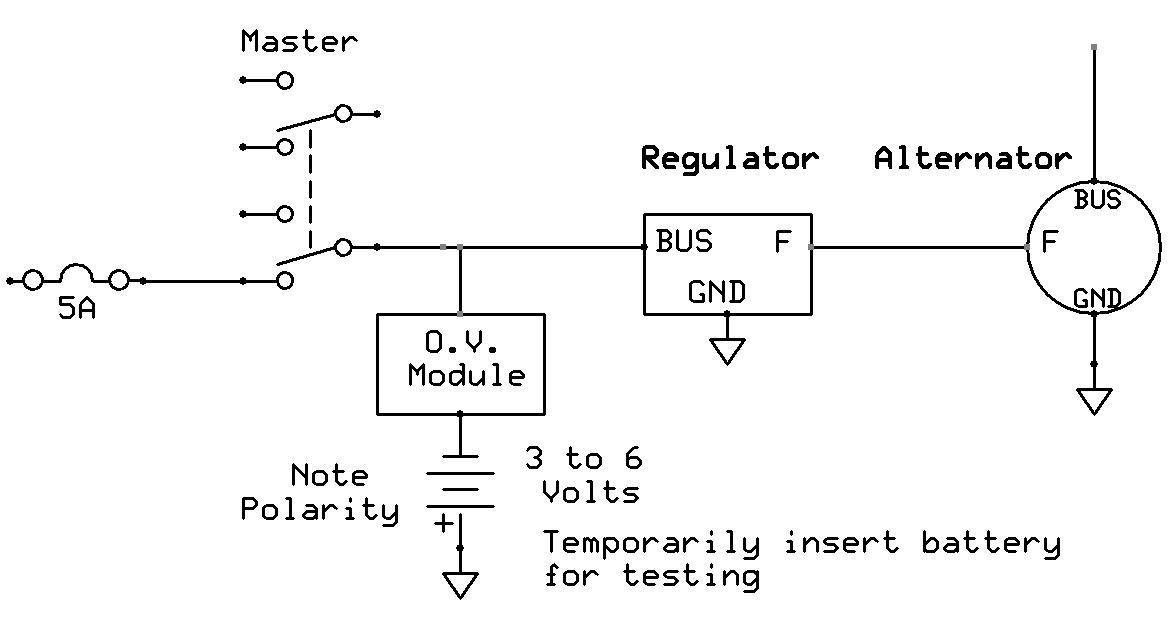

http://www.aeroelectric.com/Mfgr_Data/Regulators/Zeftronics/R15V00_Ford_Style_Reulator.pdf
0.27 volts dropped between the OV sense terminal and VR sense terminal seems high. There could be a loose connection. A fully charged battery should have a voltage of about 12.8 volts.
Attached is a circuit to test the OV protection. If the aircraft battery voltage is 12.2, connect two flashlight batteries in series with the OV ground wire. Note the polarity of the flashlight batteries. I would not expect the OV protection to trip the circuit breaker at 15.4 volts (12.2 + 1.6 + 1.6). If the OV does trip the breaker, then the OV needs to be adjusted to a higher trip point (16v).
Joe

Thanks Joe, I'll run that test when I'm back out at the airport.
