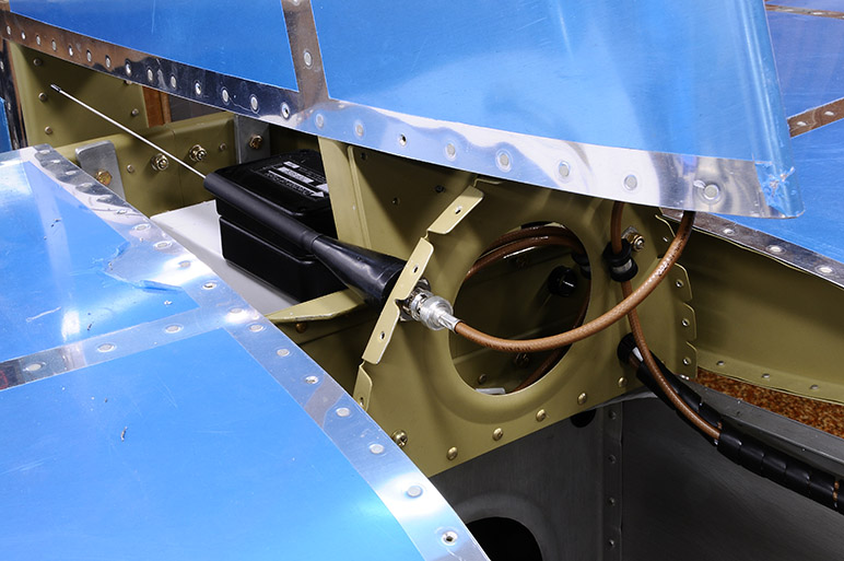

I have the Ameri-King AK-451 ELT with GPS input on the RV-8 and mounted my antenna under the fin. Seem to fit well. Attached is a picture.
Matt Dralle

 Filesize:  126.73 KB
 Viewed:  8828 Time(s)
