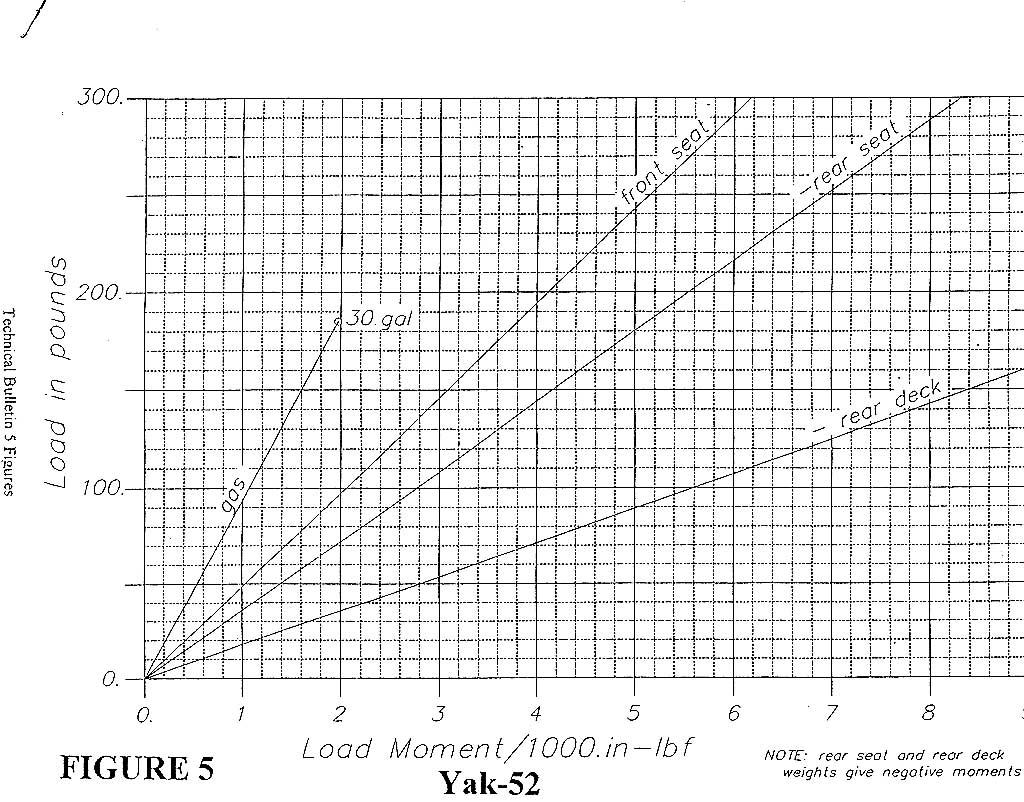

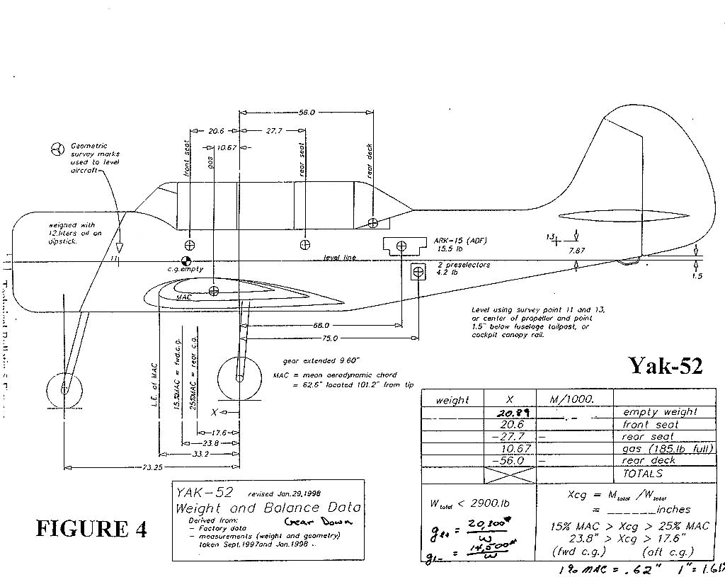

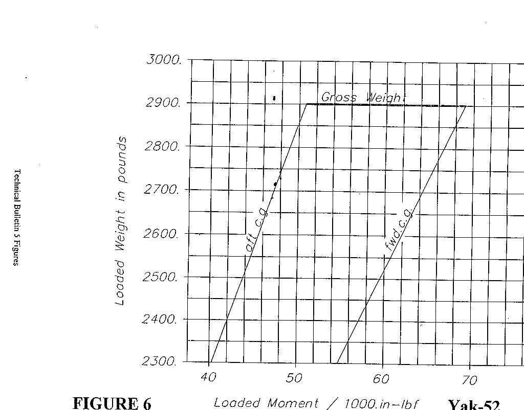

Je n sais pas si tu avais eu ces documents???
Ils peuvent t'intéresser
Didier
Le 5 janvier 2012 08:39, Jan Mevis <jan.mevis(at)informavia.be (jan.mevis(at)informavia.be)> a écrit :
I have to make a weight report of my Yak 50.
No big deal calculating the C of G, once the plane has been put onto balances.
But what I also need is a conversion to % MAC and I don’t have the exact position of the 0 % MAC.
The Russians published an MAC of 1,64 meters for the Yak 50.
I know the methods to calculate the MAC,  but it’s quite a job.
Just hoping that someone more knowledgeable than I already has done it?
There are several spreadsheets circulating on the Internet but as you could expect, they do not agree …
BR,
Jan

Thanks Didier, meanwhile I figured it all out, and have a weight report accepted by the French authorities.
