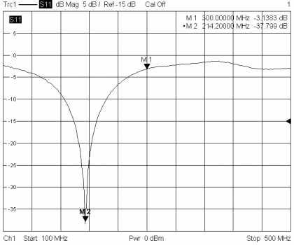

We stumbled back-asswards into an antenna engineer who works for L3 across the street from us. His hobby is helping ham operators build antennas, and he should be here Saturday to do a "sweep"...whatever that is.
A 'sweep' is done with a supper-whizzy network analyzer
usually fitted the a sweep generator and graphical display
for the output of the analyzer. You get pictures like this
in seconds
[img]cid:.0[/img]
Us poor guys use an SWR meter and variable frequency
energy source to step through the frequencies of
interest and record data. That data is then
massaged like our algebra teachers taught us. After
you've done it a few dozen times, any notions of it
being a 'sweep' are replace the realization that
it's really a 'plod'.

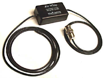

There's another 1/2-wave kid on the block which
is actually a center-fed dipole with the feedline
running up the middle of the lower half of the
dipole. It's marketed as the Air Whip at
http://miracleantenna.com/shop-products/aviation/42
[img]cid:.0[/img]
The black box houses the common-mode choke which
de-couples the feed line from the high-voltage
end of the dipole thusly.
http://tinyurl.com/78ph8nz
http://tinyurl.com/6ul4o6f
Waaayyy back when, there was a brief brush with
tiny toroids to match coax feedlines to center fed
dipoles the cores they used were very low
power handling . . . hence good for receive only.
The Antenna Dynamics product has the look and 'smell'
of a similar product. By the way, the reason it's
not 44" (half wave in free space) long is because
the lower 1/4 wave is in coax which is shortened
to about 14" by the coax velocity factor.
Miracle Antenna is a newer kid on the block
and gets very good reviews from their whole
customer base which includes amateur radio and
SWL applications.

   upper element and/or 'capacity' hat to load the
   shortened antenna thus making it look electrically
   like a quarter wave.
   Your antenna guy will know all about this and
   will be able to help you with the patch.
 Filesize:  41.48 KB
 Viewed:  6884 Time(s)
