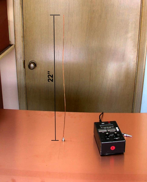

Remember this picture? I don't even recall what we were
discussing on the List but I did this little 1/4-Comm antenna
setup on a sheet of copper clad right here in the shop.
But I'm confident that we learned or demonstrated something
interesting or useful.
[img]cid:.0[/img]
