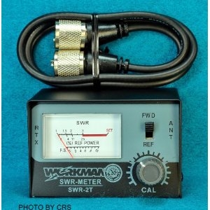

Does the MFG-862 cover the aviation band (108-116 MHz)
- Frank
Probably not guaranteed to published specifications
but still useful. There was some discussion a few
weeks back about suitability of the LO Band (3-30
Mhz) devices being used at VHF. Typically devices
like this:
[img]cid:.0[/img]
These do perform as advertised in the 3-30 Mhz
range but tend to run off into the weeds at 4x
the top design frequency.
On the other hand, the MFJ862 used at 108-135
(full range aviation) is still at 75% of lower
end of 144 ham band. Maybe not quite as accurate
with respect to absolute readings but still
a good indicator of performance and useful for
finding frequency of lowest SWR.
For about the same $ you can pick up one of these
http://tinyurl.com/6pjbckd
which is designed for our particular frequencies
of interest.
