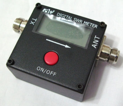

We also had some discussions about this device:
[img]cid:7.1.0.9.0.20120321190040.01dfbec0(at)aeroelectric.com.0[/img]
Which you can get off eBay for about $60 postage paid.
http://tinyurl.com/7cl4bba
I purchased one of these and found it a quite good
value. Reasonably accurate for power readings down
into the 100 milliwatt range.

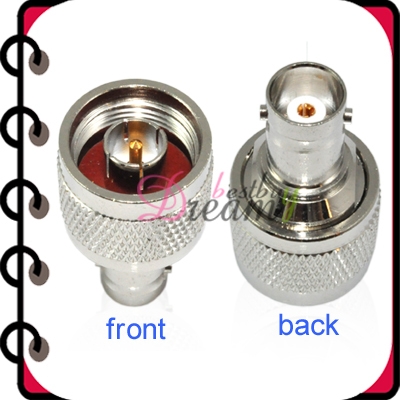

The one I have here on my bench is spoken for and
will be out of here next week . . . but the folks
offering it on eBay have plenty more. Be sure to
get two N-Male/BNC-Female adapters.
[img]cid:7.1.0.9.0.20120321190040.01dfbec0(at)aeroelectric.com.1[/img]
http://tinyurl.com/6m7ujmw
These are about $2.50 each postage paid.

PostPosted: Thu Mar 22, 2012 1:48 pm    Post subject: wingtip vor antenna - SWR Meter Reply with quote
At 01:52 PM 3/22/2012, you wrote:
Reading the page on this meter I assume it is not a good meter for use on RF below 100mHz.
It's accuracy will degrade as you depart the
manufacturer's specified range of performance.
If you buy a 'slug' for a Bird wattmeter
[img]cid:7.1.0.9.0.20120322164307.0467ecc0(at)aeroelectric.com.2[/img]
It is characterized for a power level and a
range of frequencies for which it will meet
the manufacturer's specs for accuracy.
The 'Red Dot' SWR meter is simply a power
meter with a 'fixed slug'.
