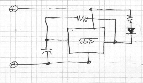

One caveat on blinking LEDs . . . they're not
very bright. When you're designing annunciators
for airplanes, your dynamic range for ambient
lighting is huge . . . especially for a bubble
canopy airplane.
I've used blinking LEDs in SERIES with high
intensity devices with some success. But the
most elegant approach for attention getting is
to have a dedicated hardware flasher for the
LED. It can be pretty simple:
[img]cid:.0[/img]
This little flasher board made with surface
mount components can be as small as .4" on
a side, maybe even smaller.
If you find that you need to over-drive an
LED to meet your illumination design goals (e.g. say
50mA from a 14v source) the series resistor
would be something on the order of
10/.05 or 200 ohms. 10 Volts dropped
at 50 mA is 500 milliwatts . . . so
using a 1W resistor would not be a bad
idea for keeping surface temperatures
down.
If you've had failures of the COTS components
then it doesn't much matter whether it was
due to resistor or lamp failure . . . the
events demand evaluation and modification
of the design to achieve a useful level
of confidence.
