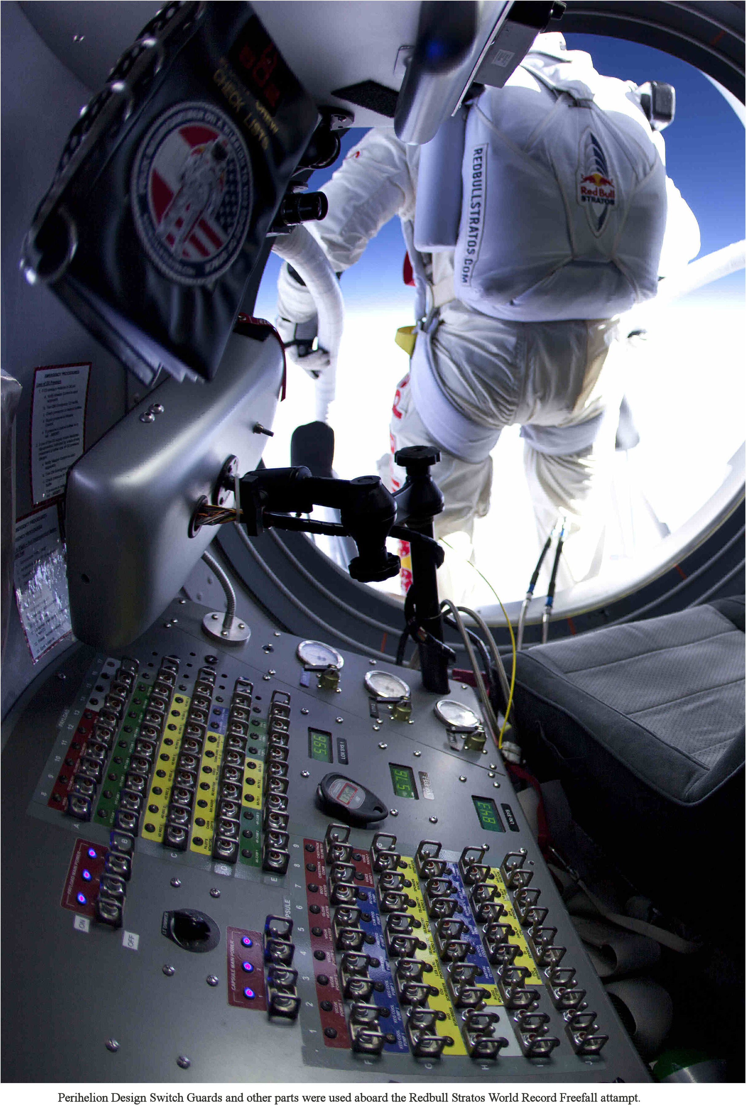

I would gladly publish the circuit but it is incomplete...as is my Glastar, which I'd better start working on. My electro-whizzie work has slowed down since I spend much of my time selling switch guards. NASCAR is also a big market. See attached. (The Redbull team was so secret at first I thought they had to be spooks!)
