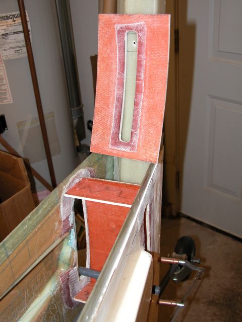

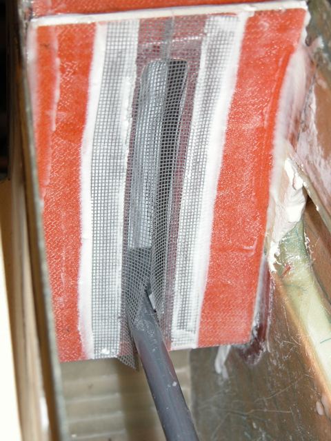

PostPosted: Sun Mar 25, 2012 2:09 pm    Post subject: TS05 retention query Reply with quote
On Mar 24, 2012, at 2:33 PM, Rowland Carson wrote:
I seem to recall that someone on this forum mentioned adding small
lightweight discs near the ends of the TS05 cross-piece, inside the
fuselage.
Rowland...I may have been the culprit...but in due course I abandoned
the notion in order NOT to add a potential glitch to pitch control.
I ended up building a little foam box with a screened slot which
centers TS05 and (hopefully) keeps the birds and insects from
venturing into the tailcone...here are a couple of pixs:
Best,
Fred
 Filesize:  50.55 KB
 Viewed:  4031 Time(s)
 Filesize:  68.4 KB
