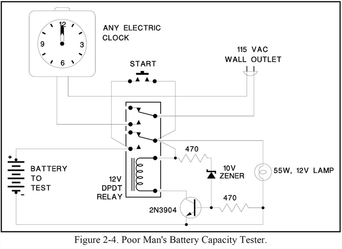

PostPosted: Sat Mar 03, 2012 10:42 am    Post subject: battery chargers Reply with quote
At 11:38 AM 3/3/2012, you wrote:
thanks bob, as the prop was sent out to be shortened i guess no time like the present to pull the battery and get a load test done.
LOAD and CAPACITY. That's one of the characteristics of
SLVA batteries that tends to convince us they are
flightworthy when in fact, they may not be.
Their internal impedance is so much lower than a
flooded battery that their capacity might well have
dropped below your design goals for battery-only
operations and still get the engine started.
One of our members just completed the 'po boy's
cap checker described here:
[img]cid:.0[/img]
After you've LOAD tested a battery to see what current it
will deliver when loaded down to 9v for 15 seconds, you
recharge it and put this fixture on it, set the clock for
noon (or midnight) and push the button. The relay will
pull in and light the lamp thus placing about a 4A load
on the battery. Adjust the number and size of lamps in
parallel to get a load that approximates your alternator-out
loads.
When the relay drops, the clock stops and you've got a
benchmark for how well the battery will support your
electro-whizzies with a failed alternator. Batteries
are mostly replaced in the heavy GA iron because they
won't power the goodies . . . not because they won't
start the engine.

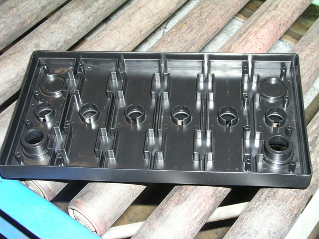

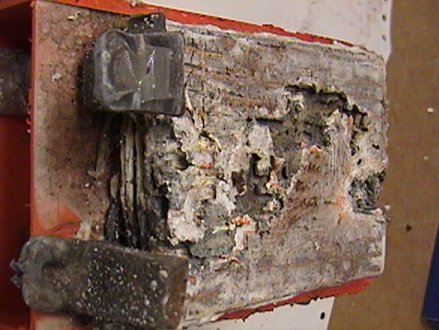

I am aware of only one in-service RG battery explosion.
It was a new model Concorde being qualified onto
a GA jet. This particular battery had been subjected to some
severe conditions of overcharging followed by
a couple of spool-ups (no ignition or fuel) on
the airplane. The evolved gasses combined with
some simulated balked starts fused a cross-over
joint between cells . . .
[img]cid:.0[/img]

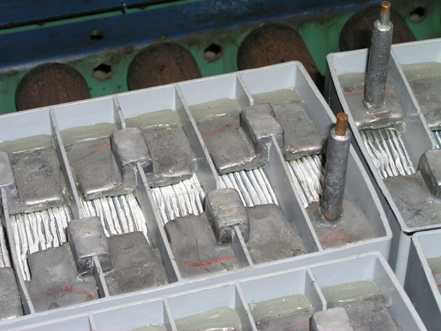

Concorde's crossovers are soldered on by hand . . .
[img]cid:.1[/img]
. . . and set high enough on the cell wall to become immersed in
epoxy encapsulant which is used to fill the inter-cell sealing
channels in the lid . . .
[img]cid:.2[/img]
Interestingly enough, this battery design had already been
qualified to the RTCA/TSO requirements . . . which seem not
to stress a battery as hard as in the incident aircraft.
Even though analysis of the event said it was not necessary,
Concorde did beef up the inter-cell connectors in that model
of battery.

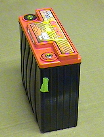

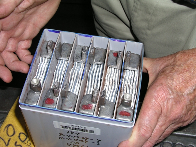

We have been apprised of an incidence of a high-energy,
internal event on a Hawker 10 AH 24V battery . . .
[img]cid:.3[/img]
Temperatures were so high as to severely char the internals
[img]cid:.4[/img]
. . . I think this event stayed inside the battery case except
for one small hole.
I wasn't informed of the history of this even but given the
battery's small size (10 a.h.) and the size of the typical
24v alternator (60A) I'm betting that the short term high
recharge rates for this battery were exceeded causing
a failure of the one cell.
The RG or SVLA battery has amassed a long history of
robust service and few exceptions for more than benign
failures . . . and they get better all the time.

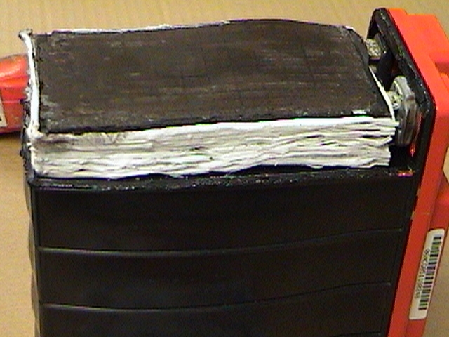

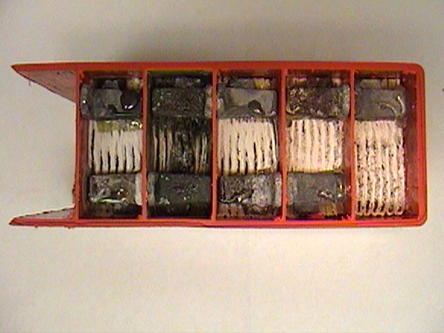

Somebody sent me an abused Odyssey some years back,
Dec 2005 I think. I sent it to Concorde and their guys
tore it down for closer examination.
In this case, the battery case was intact. The battery had
be subject to an OV condition which heated the battery up
while building large sulfation crystals on the normally thin
plates. The thing puffed up like a guppy.
[img]cid:.0[/img]
[img]cid:.1[/img]
RG batteries are not designed to withstand severe over-charging
or extra-ordinary stress such as that which produced the
one real explosion I'm aware of. After running the gauntlets at
TSO or Naval qualification labs, they are shown to offer benign
failure events when used in a system with legacy attention paid to
rapid mitigation of an OV event.
