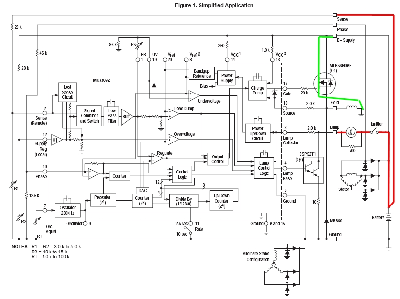

I am trying to understand the purpose of the wire to the alternator
via the 5A breaker and the "alternator switch".
Understand. Here's an exemplar schematic for an
internally regulated alternator. To the best of
my knowledge, this theme is consistent throughout
the modern alternator industry. This image was
excerpted from the MC33092 regulator data sheet which
you can get here:
http://aeroelectric.com/Mfgr_Data/Semiconductors/MC33092A.pdf
[img]cid:.0[/img]

Actually . . . pretty close. In this case, current supplied
through the ignition switch and warning light are used to
to effect an on/off control of the alternator although
switching the sense lead would do that too . . . the "LOSS
OF SENSE" circuit would detect an open sense line and
effectively control the alternator.
Although a contactor could be installed per Z-24, that seems like a
poor way to patch the problem.
I'm certainly amenable to a better idea. This problem
has been wrestled with by many folks over the years.
I don't know if my fellow builder is up to the task of modifying the
alternator. Unfortunately, he is in a different country than I, so I
can't just pop over to look at it. I expect it voids the warranty to
cut the regulator out. I expect the best thing is to recommend that
he obtain a more suitable alternator.
Yup. But as you can see in the exemplar schematic, there
are failure modes that can and have produced uncontrollable
runaways. The legacy recipe for success has been to gain
direct access to field excitation . . . which requires
modifications not unlike those offered by B&C and PlanePower.

Understand. Here's an exemplar schematic for an internally regulated
alternator. To the best of my knowledge, this theme is consistent
throughout the modern alternator industry. This image was excerpted
from the MC33092 regulator data sheet which you can get here:
Thanks, Bob. This is what I needed to read to understand the issue.
I guess this makes sense to the auto industry.
The IC does try to handle under and overvoltage conditions, but that
is like asking the fox to guard the henhouse.
Modifying this circuit would be difficult. Much easier to delete the
regulator in favor of an external one. Even easier still is selling
the existing alternator and purchasing a more suitable one, which is
what he has decided to do.
Thanks again for more education !
Jeff Page
