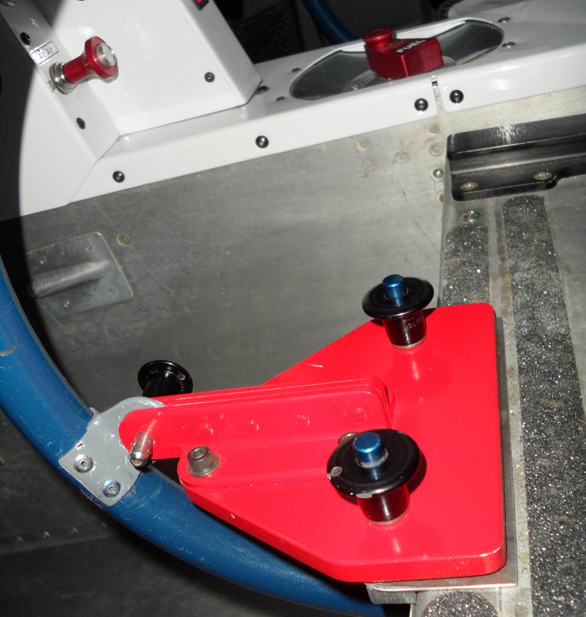

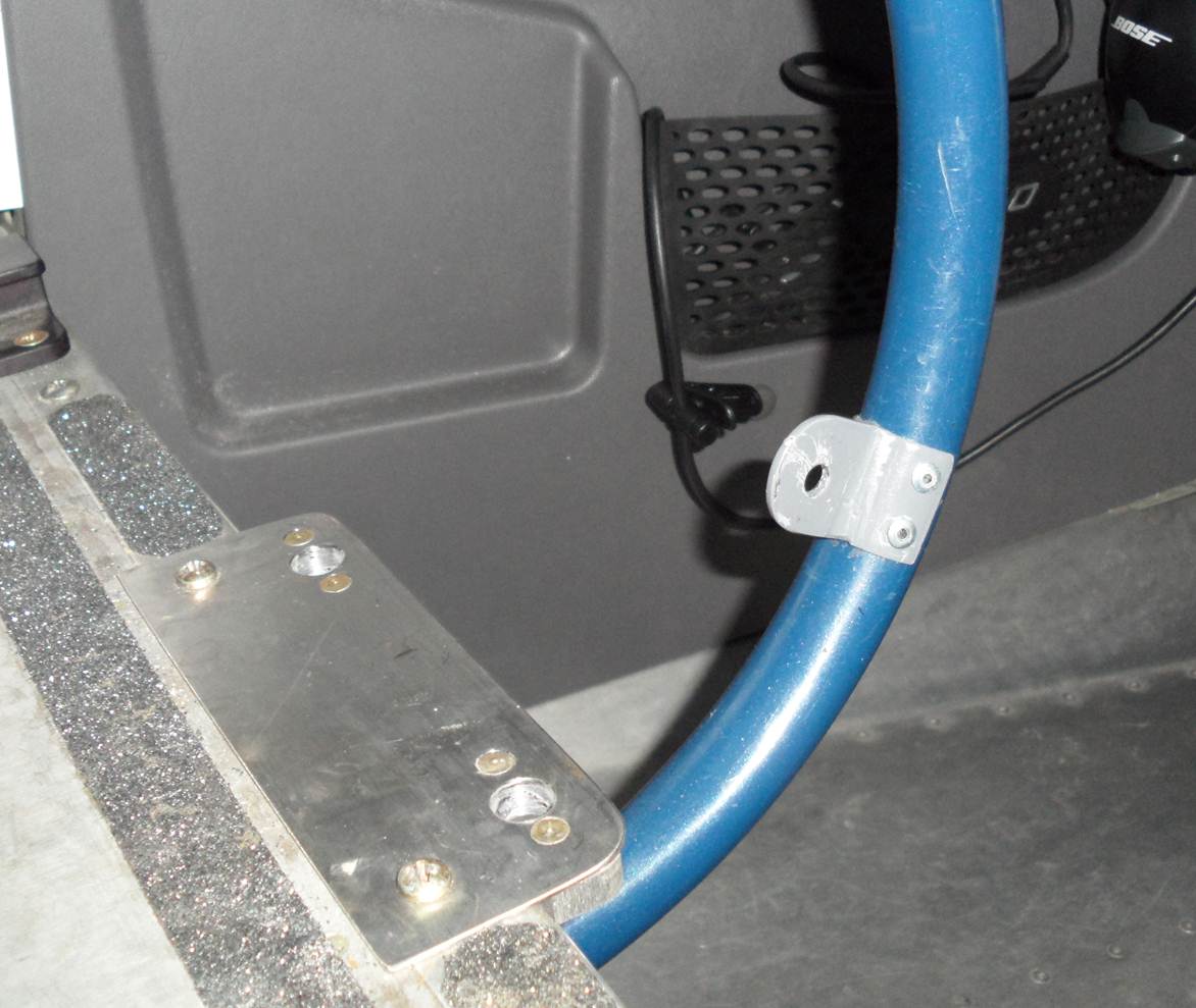

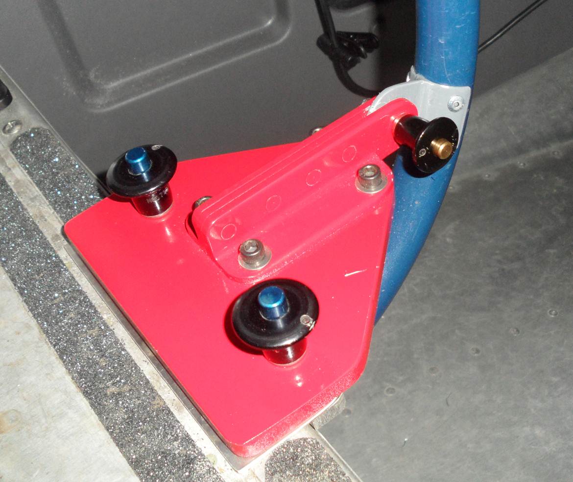

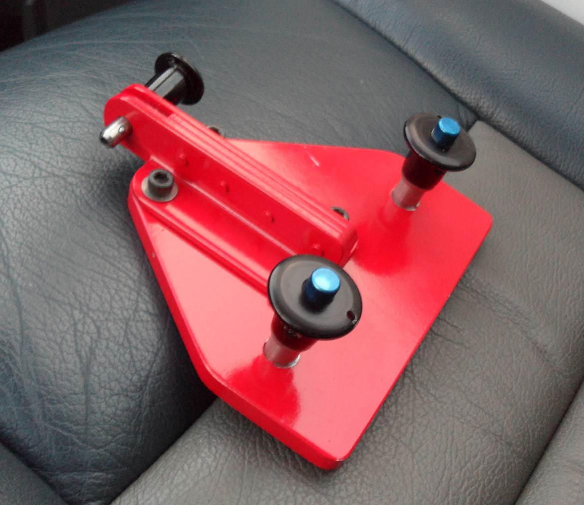

We recently have been experimenting with a gust lock mechanism for our RV-10 that holds the stick in place w/o the use of seat belts etc… The goal was to design a small unit to lock the control surfaces in a neutral position without using the seatbelts or other systems that could shift over time. We played with a number of different designs but most were not completely successful due to the curvature of the stick around the binding area. Ultimately we decided to place a hard point on the stick to guarantee no movement when attached. I was worried that the stick hard point may get in the way but it is a non-issue. Photos of our final design.
The above design is made from solid stock. Had we to start from scratch we would probably build it out of thinner (lighter) aluminum made structurally sound with reinforcement and bends. Also properly designed a single seat side pin is all that would be needed. We ended up with two pins because the holes were already there from a prior concept.

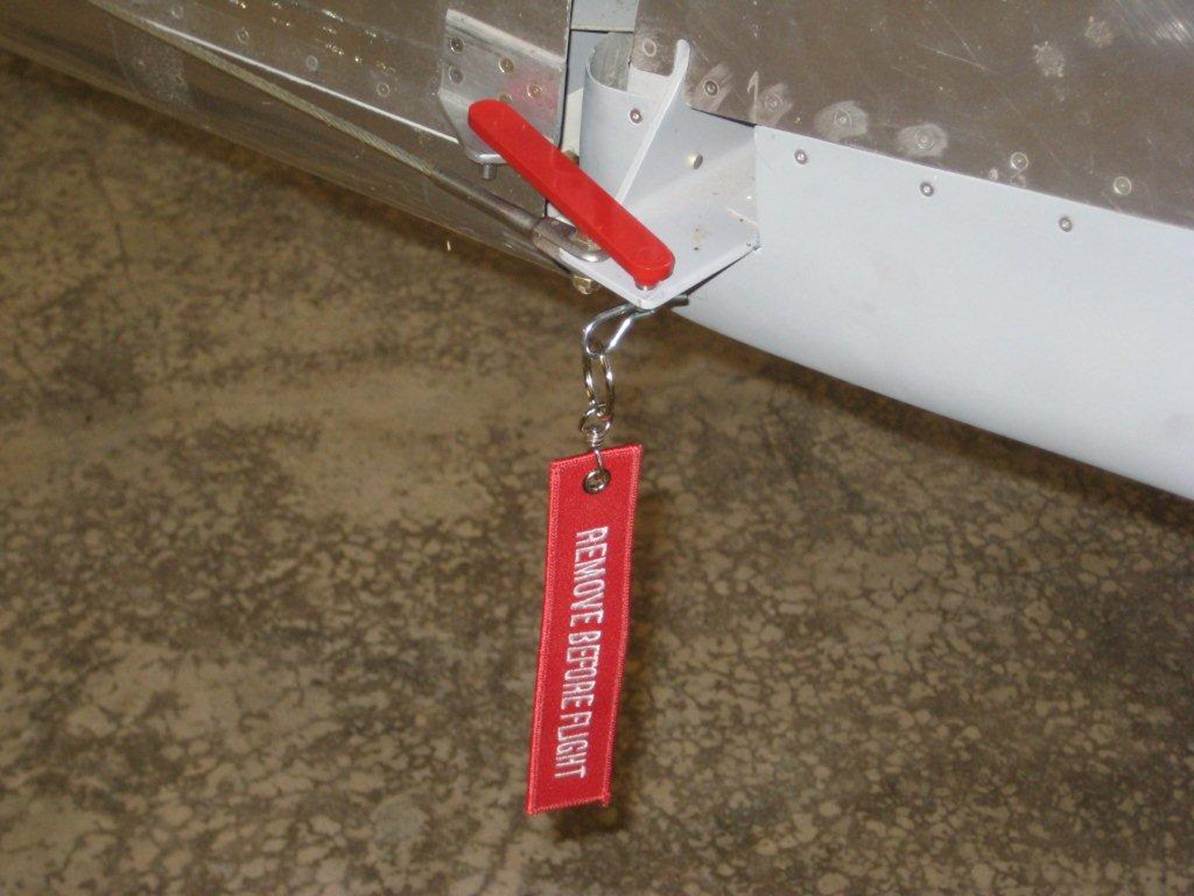

Mate this with our Rudder Gust Lock (below) and you have a pretty simple & small locking system. I keep both parts in a Ziploc bag stored in the baggage area.
Robin

Robin, if there are no clearance issues, then it looks like an excellent design. Just out of curiosity, would this design also allow for an optional crotch belt?

Zero clearance issues.

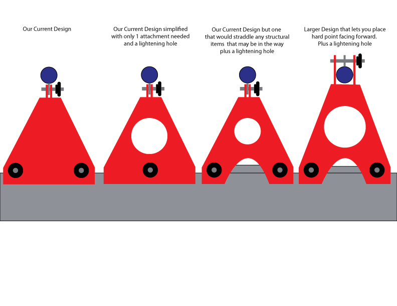

I don't fully understand your question. Are you saying you have a crotch belt and want to know if our design will work when considering the belt attachment area? Because the -10 is the only movable seat in the RV line of aircraft I don't see how anyone has a crotch belt for the front occupants. Not sure where it attaches with the seat moving forward & back? That being said our design should work because we basically attach forward of the leading edge of the seat "bench" area.
Regardless there are MANY different ways to attach to the "bench" area, the key was the hard point on the stick. Even that can be varied by having the hard point facing forward vs. facing aft in my set up and making the actual gust lock grab around the stick and connect to the forward facing hard point opening. One could also make the attachment area "straddle" any items that may be in the way. I drew up a few different concepts to consider (attached).

Jason. Not trying to sell just share with the community. It works extremely well but one has to be willing to add the stick tab. The tab has been a non issue since install and the lock is rock solid.
