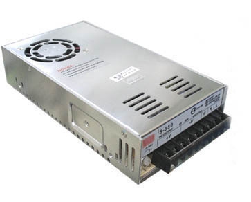

PostPosted: Tue Mar 06, 2012 2:51 pm    Post subject: OT: Old electronics info. Reply with quote
Almost forgot. If all you want to do is fire up
your airplane or car's accessories on the bench,
perhaps you don't even need an adjustable power
supply and meters. These power supplies are
http://tinyurl.com/7dqjkve
[img]cid:7.1.0.9.0.20120306104210.01dfb188(at)aeroelectric.com.0[/img]
an excellent value. This 13.5 volt, 28A power supply
is $40 delivered to your door. 28 amps will run a lot
of stuff.
