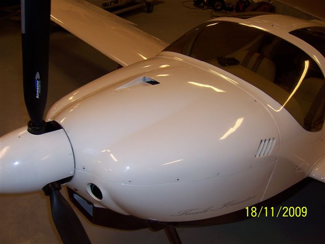

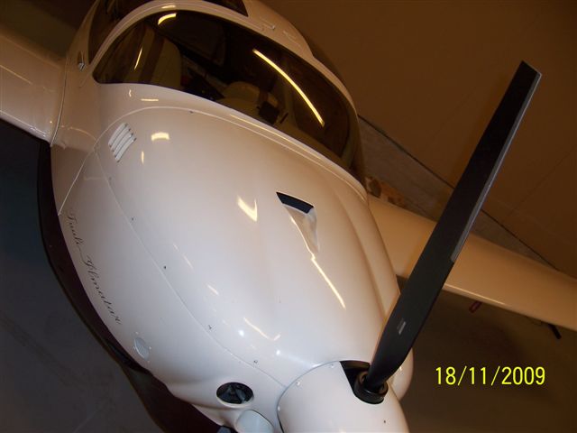

I used Mil Spec Production C-2000 Fastening system, which is fully Camlock compatible. allekirjoitus http://www.milspecproducts.com/
Contact them Sorrento, Florida.
Using these is a real and practical safety mod: if you have original screws, you will not open the cowls as often you should.
With C-2000, you can open the cowl(s) in seconds. I have done it around 500 times.
And then you are able to leave those hyperugly inspection hatches off and save building time also!
They are like perforations and facial piercings on the face off a beautiful woman...sorry.

PostPosted: Thu Jan 12, 2017 12:01 pm    Post subject: CAMLOC Fasteners Reply with quote
As a consequence of my novel engine installation, I’ve been particularly concerned about easy access to everything under the cowl and have opted for hinging it rather than rely upon the typical, small, access panels. I’d also had some concerns about a de-mounted top cowl being blown about the tarmac.
Notwithstanding the geometrical challenges, I’ve fabricated some spring-loaded, concealed hinges as shown in the pixs, allowing for a total of 6 CAMLOCs to secure the cowl in place.
[img]cid:E22B8756-738F-45F7-85FA-D05E12B0DCD2[/img][img]cid:0431251B-3F04-4E3B-AD46-68B7D8C1734B[/img]

PostPosted: Sat Jan 14, 2017 10:53 am    Post subject: CAMLOC Fasteners Reply with quote
Fred,
Very nice installation!
Bob
