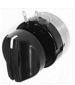

I have a small 8-ohm speaker that I plan to connect to the speaker output of my XCOM-760 radio. For speaker volume control, do I simply wire a potentiometer into one of the wires going to the speaker, introducing a variable resistance in series with the speaker coil, or is something more specialized necessary?
There's a specialized device for direct
control of speaker volume called an L-pad
which has all the appearances of an ordinary
potentiometer . . .
[img]cid:7.1.0.9.0.20120302191906.03402968(at)aeroelectric.com.0[/img]
. . . but specifically designed to work with
low impedance speakers. See:
http://tinyurl.com/84jwt7v
I think that radio's volume control affects
both the headset and speaker volumes. Do you
anticipate simultaneous use of both headphones
and speaker such that independent control of
each is necessary? If so, it could be that
setting the radio's volume for the desired headset
level will leave you short on speaker volume
so that even with the l-pad set for wide-open,
the speaker volume is found wanting.
