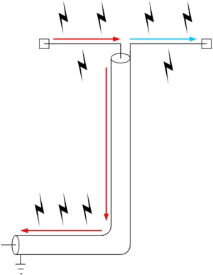

Some years later, Jim Weir suggested adding ferrite
toroidal cores the coax right at the junction with
the antenna. The idea was to reduce coax radiation
depicted in the Wikipedia article
[img]cid:.0[/img]
. . . radiation caused by less than ideal termination
of the feedline. I tested this work-around in the EMC
lab at HBC about 15 years ago and found that an array
of 10 cores had no appreciable effect on these stray
shield currents.

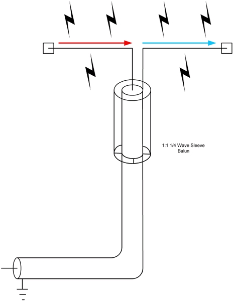

Years later I suffered this "hot-d(at)#n" moment. I saw
an antenna product wherein the string of ferrites was
replace with a single ferrite core. The coax was
wound through it several times.
[img]cid:.1[/img]
But of course! Inductance in a single magnetic circuit
varies with the SQUARE of turns. The picture seen here
has 6 passes of the coax through the core. It is the
electrical equivalent of 36 single cores. Now, having
'discovered' that, it would still be interesting to
go to the lab and see how effective it is.

The genesis thread discovered that making the servo
more robust to the strong RFI environment was
a good solution. But given that it's a plastic
airplane, it's not clear that refining the
antenna's feed point design would have made any
difference at all.

The Wiki site shows a simple dipole and the caption says:
"A schematic of a half-wave dipole antenna connected to an unbalanced
coaxial cable. Better practice is to connect the balanced dipole to
the unbalanced line with a balun."
. . . and I published instructions for adding this
feature to a coax fed dipole at
http://aeroelectric.com/articles/BALUN/Balun_Fabrication.html
. . . the same technique could be applied to a comm
dipole.

You are correct. If one compares the Pawsey stub with a
1/4 wave, de-coupling sleeve or "sleeve balun" as shown in Wikipedia:
[img]cid:.0[/img]
. . . we see that the top end of the sleeve is the open end
of a shorted 1/4-wave transmission line. I.e., the
impedance of the top rim of the sleeve looking at the
shorted end is very high. Hence, connecting it to the
center conductor adds no 'load' to purposeful energy
but it would have the effect of collecting differential
currents between coax shield and the center conductor
and force them toward equivalency.
The Pawsey stub functions in the same manner except that
its behavior is more like a short piece of balanced
transmission line as opposed to a piece of coax. This
brings to light an error in my balun article cited
earlier. Since the stub IS NOT operating as a free-space
1/4-wave but instead as a transmission line, dielectric
effects on velocity come into play. The velocity factor
of this piece of transmission line is on the order of
.95 to .97 which means that my 26" dimension for the
stub would be closer to optimum were it shortened by
an inch or so.
The 'coiled coax ploy" has good foundations
in physics. Consider this image from the Wikipedia
article:
[img]cid:.1[/img]

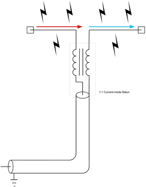

The current balun is a common mode choke which
may be implemented by wires on a high-efficiency
core (as in many TV couplers), a coil of coax
immediately adjacent to the attach point on the
dipole or consider this image also from Wikipedia
article on baluns:
[img]cid:.2[/img]
As you can see here, the common mode choke effects
are greatly enhanced by winding the coax onto
the core. Inductance in these windings is proportional
to the permeability of the magnetic path material.
Air is 1.0, the ferrite may be 5-20 . . . thus
multiplying the beneficial effects by that factor.
The neat thing about this balun is that it is not
resonant or tuned; thus effective over a wider range
of frequencies. The stubs in coax or balanced transmission
lines are tuned and optimum at one frequency only.
The 'hard' thing about the coax on core ploy is finding
coax that will wind tightly through a relatively
