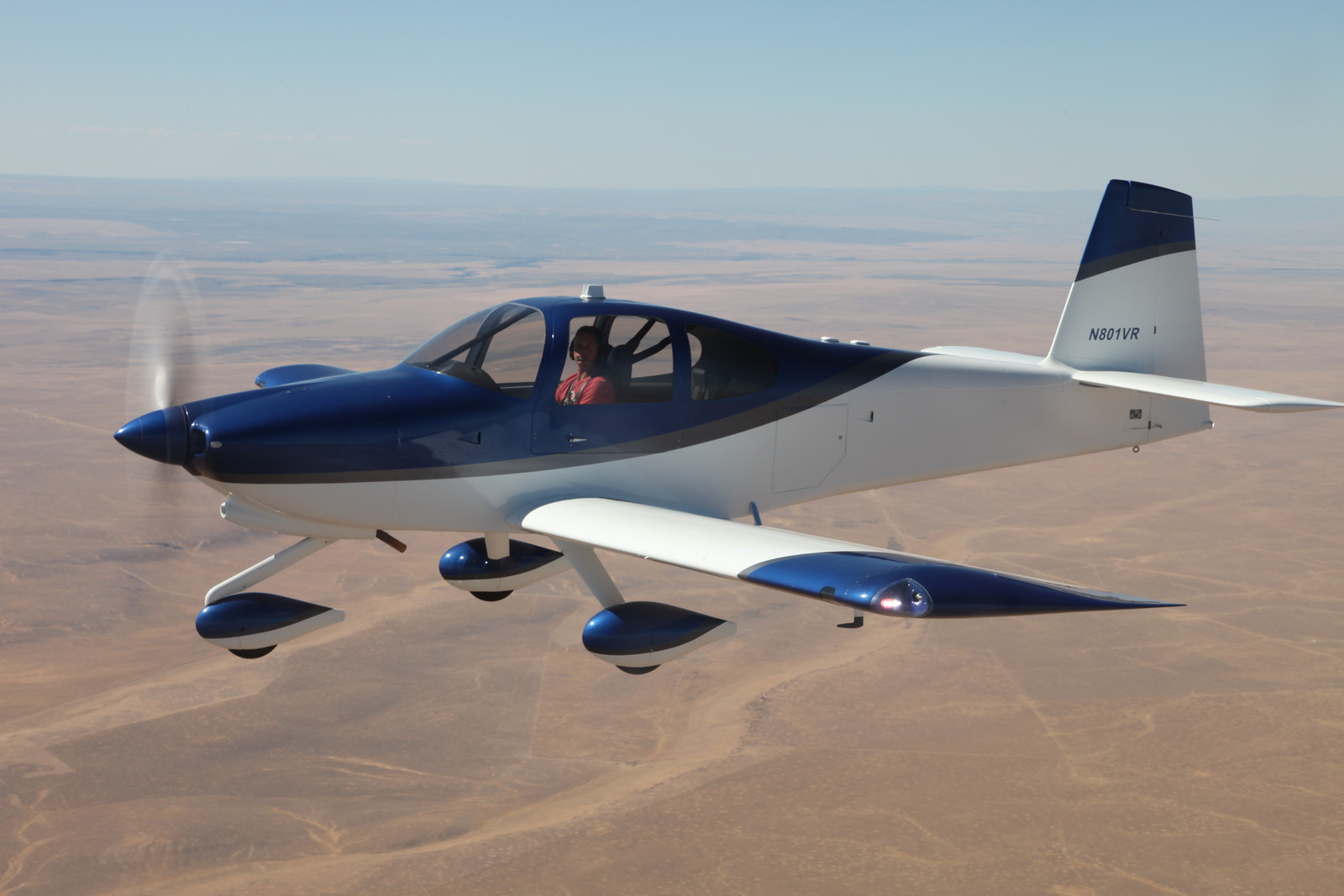

Mine is up top and out of the way. It would have been easier to mount it earlier in construction but it worked out great. I made a nutplated doubler to mount the CI-157P and used the 5/16 pneumatic airline to run the coax up the nose of the vertical ribs. Best pic of it I found. Apex is toward the nose.
[img]cid:E56376924C264EA6905997096CD55440(at)JMThomas[/img]
 Filesize:  227.69 KB
 Viewed:  10089 Time(s)
40936
