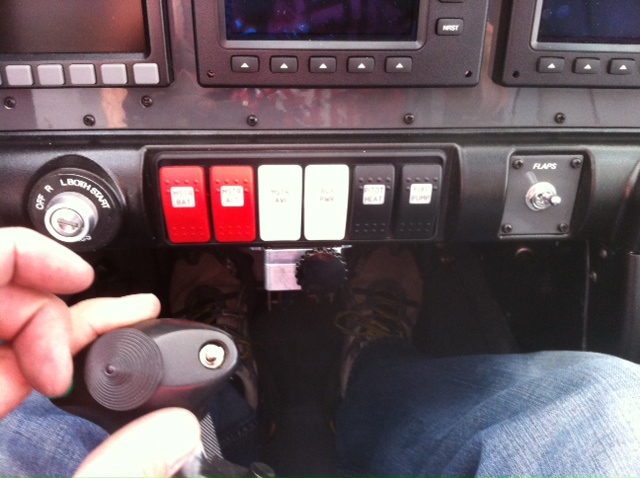

I just installed a rudder trim today that Aerosport Products made. I am testing the design and was very pleased with the results. I didn't want the electric rudder trim since it was a lot of labor and put weight in the rudder. I was holding out for a bias system that used the entire rudder. I know builders who installed the electric version and like them but this new product was just what I was looking for. It literally took me 30 minutes to install and worked perfect. I didn't know where to set it for the first test run so I took off normally. At cruise I dialed it in and immediately was grateful to pull my foot off the right rudder where I had been resting it for the 180 hours I have on the plane. This system uses a dial which is geared to two cables attached to springs and finally hooked on to two clamped arms on the rudder crossover tubes. I can dial in the cruise descent and cruise climb in a few seconds. It is very compact as you can see in the photo. I'm already happy with it and I only flew with it for a fairly short flight today. I took a quick pic with my iphone and will get some better pics later. Feel free to contact me with any questions.

It looks like the same system that I installed - bought from M.L. Skunk Works several years ago. It works great. I will admit that the RV-10 needs very little rudder trim in cruise that I can see.

Not really, the concept is similar. The control head is significantly smaller and my very biased opinion is that it's better engineered.
