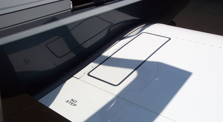

Always interested in trying something new (for better or worse) I used a material designed to add a non-skid texture to paint and painted my wing walks clear over the white basecoat. Then color matched the outline. See below:
I wanted to extend the length of the wing graphically which I think has worked to nice effect. That being said it's not ideal for most people, muddy feet and all. If I were to do it again I would use the exact same non-skid material but color match the step area my dark blue/grey.
Oh, one more thing. When I chose to go this route I slightly undersized the area vs. the standard wing walk tape Van's sells in case I had to cover up my mistake but I am pleased with the performance of this surface. Sorry I don't recall the non-skid material.
