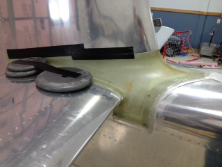

  • Work on one side of one fairing at a time (for instance, if you are working on the upper fuselage to gear leg intersection fairing, work on the fuselage to fairing interface first. Second time around work on the fairing to gear leg interface). Lay up 2-3 layers of approximately 9 oz cloth on the fuselage over the line drawn in step 1.
  • Mix up flox and epoxy to a peanut butter consistency and apply about 1/16”-1/8” onto the fairing surface that mates to the fuselage. This will help fill any gaps that may be present due to poorly formed fairings.

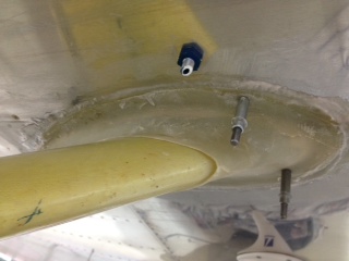

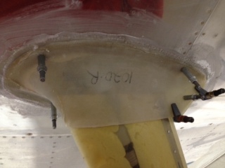

  • Mash the fairing onto the fuselage in position. Use cleco’s/clamps/screws/whatever you desire to hold it in place exactly where you want it until dry.
  • [img]cid:3413398331_8032640[/img][img]cid:3413398331_8048117[/img]

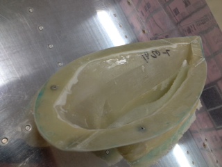

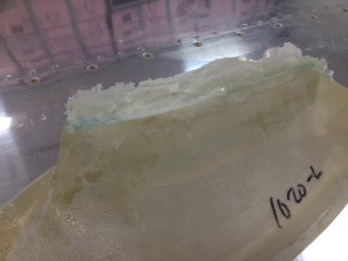

  • Once dry, use compressed air to blow it free from the fuselage. Its amazing how well the compressed air works. Just get a little spot to break free, then blow air in the spot and the whole thing will pop off pretty easily.
  • Clean the fuselage up with a plastic scraper and acetone and clean real well.
  • Trim the fairing edge as desired to get a smooth edge.
  • [img]cid:3413398331_8002281[/img]

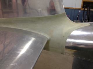

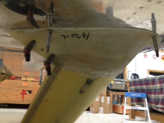

  • Repeat the process for the other side of the same fairing. For this example, that would be the upper gear leg to fairing surface (or the lower line as described above). DON’T FORGET THE MOLD RELEASE ON THE SURFACE YOU DON’T WANT IT BONDED TOO!
  • [img]cid:3413398331_8002797[/img][img]cid:3413398331_8028793[/img]
  • Once complete, fill and sand, and fill, and sand, and fill, and sand until it is smooth to your satisfaction.
For the rear empannage intersection fairing, I followed the same process, but layed up the HS to fairing surface first, then the VS to fairing surface second.
[img]cid:3413398331_8008721[/img][img]cid:3413398331_8043704[/img]
