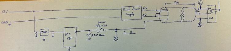

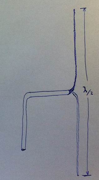

I’m hoping that an RF greybeard will be able to offer some advice… I’ve built an elevator trim system for my aeroplane, using an RC servo mounted in the control surface, which is driven by a PIC18F microcontroller. This has worked flawlessly for 2 years.
On the back of this success I built another identical one for a friend, and due to the difference in installation which I’ll explain shortly, I am being plagued by a fault that I haven’t been able to solve. The instigator for this problem is the RF emitted by the COM antenna, which on my aircraft is between the undercarriage (taildragger), and on the friends is inside the vertical stabiliser. The design of the friend’s antenna is as follows:
The braiding of the coax is stretched out in one direction whist the core is stretched out in the other. Since it’s a fiberglass aeroplane, the antenna is bonded to the skin of the vertical stab, without worry of electrical problems.
The design of the trim system is as follows:
Ship’s power is fed through a 7805 (with required smoothing caps) to the 18F4520, which generates the 1-2ms square pulse required by the servo. The output of the PIC is protected by a polyswitch and zener diode combo, resulting in a fairly low impedance output. Meanwhile, the power is fed into an off-the-shelf RC power converter, which has a 6V, 15Amp capable output. Signal and power is fed through a shielded 4-core tefzel wire to the back of the aeroplane where it breaks out into the connections required by the servo motor. The 6V power line is fed over two cores, whilst ground is connected via one core and the shield.
The problem: when transmitting on the radio at the low end of the airband spectrum 118Mhz, the servo goes bezerk. At 125MHz it twitches occasionally, but is mostly usable.
I took an oscilloscope out to the aeroplane, and tested at points “A”, “B” and “C” whilst both transmitting and not.
At “A”, the signal output by the PIC is clean, and unaffected by the noise induced by transmission. The same signal is measured at “B” whilst not transmitting:
When transmitting, however, the signal at “B” becomes completely degraded:
The amplitude of the noise is approximately 5Vp-p, superimposed on the desired 5Vp-p signal. No wonder the servo doesn’t know what’s going on!
The power line is completely clean on both ends of the wire, at “C” and the output to the power converter.
I am aware that the suitability of using an RC servo in a real aircraft is a concern, but as has been proven in my aeroplane, mechanically and aerodynamically the system works well, providing enough authority to trim adequately without being so powerful that it cannot be over-ridden using excessive force. The microcontroller code and electrical design of the board has also proven to be reliable, and the installation in my aeroplane has been robust and able to withstand the noise generated from the com radio, although the distance to the antenna is much greater (not closer than 2 meters). We both have the same radio, an MGL VHF-10.
In the knowledgeable opinions of those who have RF experience, will I be able to implement a filter at the servo end of the wire to filter out the 120MHz-odd signal whilst retaining the integrity of the pulse? I tried using a 1uF electrolytic cap as a filter (this was the only cap I had on-hand, as the aeroplane is a 90min drive out of town), which had no effect on the noise, and only degraded the underlying signal further. I know that the cap isn’t rated at high frequencies, so I only include it as an anecdote. I’m concerned about putting a ceramic cap in a EM field – will this not act as an antenna and make the problem worse?
Any advice would be appreciated!

PostPosted: Thu Feb 16, 2012 7:27 pm    Post subject: Servo problem Reply with quote
Absolutely. The variable position pulse is about a
half light-year away from the antagonistic signal . . .
well . . . maybe not light years but certainly separated
by many decades of RF spectrum separation.
We're talking sub killohertz versus 100 mHz or about
5 decades. A filter crafted to attenuate 100 mHz is
totally transparent to your signal-of-interest.
Based on your explorations and observations, it seems
likely that the RC servo is having problems with the
stronger RF field. RF, like all electro-magnetic
propagation attenuates based on the "square-law".
If you double the distance between emitting and
detecting devices, effects on the detector are
reduced to 1/4th of the original. That's a FAR FIELD
condition where there are no, distortions to the
field as it crosses the gap.
We know that the closer proximity of antenna
to servo can offer a profound increase in potential
interference. You also have NEAR-FIELD effects airplane
and wiring geometry. Far-field effects are only slightly
affected by frequency, near-field effects include
the effects of standing waves on airframe and wiring
which can be VERY sensitive to changes of frequency
for the antagonist signal. I can show you data
gathered in the hell-hole of a Hawker 800 were standing
waves generated by a poorly designed antenna system
would offer 1000:1 variations in interfering signal
while standing in one place and moving a probe around
within arm's reach. Further, the effects varied profoundly
from airplane to airplane.
Ceramic capacitors are not counter-indicated
for this task. The few R/C servos I've played
with all had plastic cases and ZERO provisions
for managing electro-magnetic compatibility.
Without taking your servos to the lab and doing
the full DO-160 work-up, I cannot offer anything
like an elegant, optimized solution.
I will suggest some sledge-and-crowbar techniques
with a high probability of success.
I would "wrap" the servo in copper tape to craft
a metallic enclosure. I would fabricate two, pi-
section filters on the outside surface right where
the wires come out of the actuator. The actuator
ground would tie to the outside copper shell.
Two capacitors for each of the two filters would also
solder directly to the shell. The schematic would
look something like this.
http://tinyurl.com/6vekr2o
The actual parts values are exceedingly un-critical.
Components spanning perhaps 1000:1 ratios of
value would do the job without degrading the
command signal. The elegant components are
driven more by physical characteristics that
lend themselves to "spider-webbing" onto the
side of a thin walled, copper box.
If you could send me one of the servos along with
a picture of the installed servo showing where
the envelope could grow some warts without hitting
anything in the airplane, I can pretty quickly
accomplish the proposed modification. I would
take pictures of the process and provide a bill
of materials.
If the mod proves successful, I'll publish the
solution to the AEC website. If there's a demand
for these filters, we could do an etched circuit
board layout and fab a Mk II filter from surface
mount components. More elegant yet.
If you'd like to take a whack at a DIY solution,
I'd start with inductors on the order of 1 uHy
and capacitors on the order of 1000 pF. And yes,
they could be ceramic disks . . . just keep the
leads short.
By the way, ferrite beads on the wires are exceedingly
unlikely to fix this. Benefits of ferrites as
over-the-bundle solutions to EMC problems are exceedingly
over-rated. Any device destined to fly on a TC aircraft
would have run the DO-160 gauntlet and enjoys necessary
filters INSIDE. Any installation instructions that
call for external fixes or prophylactics to be added
as part of the installation process says the designer
has not done their homework.

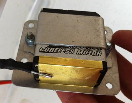

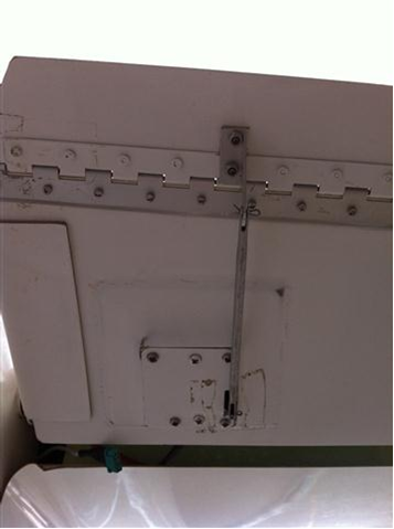

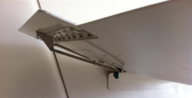

PostPosted: Mon Feb 20, 2012 9:39 am    Post subject: Servo problem Reply with quote
Hi Bob
Thanks for the advice, and the solution! I installed a Pi filter only on the signal line, but with components of 100pF and 10uH, as that's what was available. The power line didn't seem to be affected by the noise, so I decided to try just the signal line first, then add the power line filter if required.
I also added a shield to the bottom of the servo using brass shimstock (I figured it was almost the same as copper foil, but somewhat more available - however not quite as solderable).
The soldering in the photo doesn't appear to have flowed and stuck properly, but I gave it a good tug and it didn't come loose, so I just attributed it to the brass. The filter is inside the heatshrink, well supported from vibration.
The servo is a Turnigy HV-767 (http://www.hobbyking.com/hobbyking/store/uh_viewItem.asp?idProduct=9983) - a 31kg.cm monster, but is still the standard size, which makes it small enough to fit comfortably in the elevator. The casing is aluminium, save for the plastic cap at the bottom where all the electronics sits. At $60 a pop, it's a fairly cheap alternative to the Ray Allen servo, and capable of being used for much more than just trim.
The installation space is really tight, which meant that the filter had to sit outside the cavity, which limited my options for shielding hence the small strip over the bottom of the servo.
After adding the filter and the shielding, the signal going into the servo is absolutely clean, without a shred of noise visible on the signal line. The servo doesn't even notice the radio transmission now, so I'm very relieved!

Thanks also for the offer of crafting a more
elegant solution. Since the filter is so simple
to fabricate, and seems to work in this really
abusive environment, I wonder if it's even
necessary…? With plugs and attachments it'll
probably be unwieldy to install in such a small spot.
It wouldn't necessarily have any plugs, only
attach pads for wires. I envision an ECB perhaps
0.7" x 1.0" that would accommodate surface mount
components on one side leaving the other flat.
Holes in the corners would let you solder-thru
to attach the board directly to the outside copper
foil on the actuator while simultaneously grounding
the filter to the foil.
Wires would come off each end. They would, of course,
be strain relieved with adhesive or perhaps tied
down with another layer of copper tape over the whole
filter/wiring installation.
Pretty small and low profile.
In any case, it looks like your dragon has been
held at bay.

PostPosted: Fri Feb 24, 2012 7:39 am    Post subject: Re: T-antennae Reply with quote
Etienne drew a T-antenna on his discussion of the servo problem. This incluced stripping back the insulation on a coax, separating the shield and core, and stretching out each to form a Tee.
Clever. Actually too-clever-by-half. Would that it could be so easy! The problem lies in the termination, since the core and shield do not share the signal. In fact neither the core nor the shield even CARRY the signal.
See: periheliondesign.com/downloads/Dabbling%20with%20electricity.pdf
Then grab your SWR meter and Google any of the ham radio sites and see how to design a T-antenna.
Might it work the way Etienne shows? A little probably, but let's do it right.
