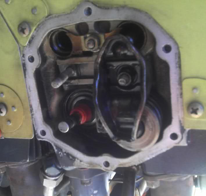

Yes I would be most interested in sealing the intake valves but the certified Continentals seal both and the RV guys that are into this have sealed both. I hear that Lycon even machines the guide to fit a seal on it.
Apparently with Gapless rings, you suck a lot more oil so they started using the seals
Check it out here:
http://www.vansairforce.com/community/showthread.php?t=69483&highlight=Gapless+rings+seals&page=2
http://www.vansairforce.com/community/showthread.php?t=56297&highlight=Gapless+rings+seals
See the red seal?
Ned

<pre><b><font size=3D2 color="#000000" face=3D"courier new,courier">
 Filesize:  29.87 KB
 Viewed:  8042 Time(s)

Kinda makes that whole 'squirting oil at the valve stem' seem silly now. Not enough exposed to do any extra cooling.

Bill Marvel and Bill Scott make for some very interesting reading and have a very strong argument in the following articles:
http://egaa.home.mindspring.com/valves.html
Especially this article:
http://egaa.home.mindspring.com/engine2.htm
about the Lycoming TIO-540-AF1A Oil Cooled Exhaust Valve Guide Kit
Their arguments seem to be verified by what Lycoming did to cool the exhaust valves with more oil flow onto the stems.
I agree that the valve stem seals certainly go counter to trying to cool them.
I guess it just depends on what you are trying to do. It's a catch 22 isn't it?
Sure would be great to see some R&D by Lycolming on these issues.
Check it out here:
See the red seal?
[img]http://thumbp4-gq1.thumb.mail.yahoo.com/tn?sid=18014403058016300&mid=AEG3iGIAALUUT0PFjg1a0XwbFkE&midoffset=1_43049&partid=2&f=1146&fid=Inbox&httperr=1&h=600&w=600[/img]
