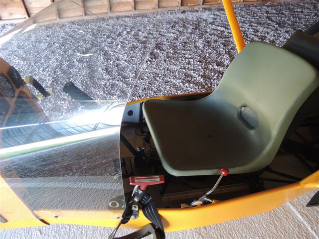

My solution? An ugly green $9.95 Walmart / KMart / Academy Sports bass boat seat trimmed of all ribbing and edging. This produces a nice rear-end-shaped bucket that the Kolb Firefly sling then supports quite nicely. Use four 1/4" blind nuts and bolts with metal straps underneath to fasten the shell to the lower seat bar on the Kolb cage. This actually aided in scooting me back an additional 5 - 6 inches (I'm 6' 7").
Then I bought some cheap naugahyde-like fabric and sewed a wedge shaped cushion with a zipper I then filled with extra firm foam, using Velcro to hold it to the seat.
http://phactor.com/BassSeat1.jpg
http://phactor.com/BassSeat2.jpg

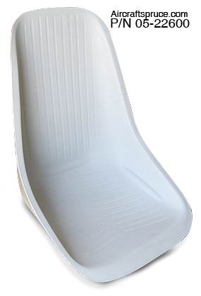

Hand layed up for extreme lightness. Wt. 3 lbs. 10 oz.
Thats it !
The below seat dimensions are as follows,
18" wide
21" high
16" deep.
Thanks C-Flyer

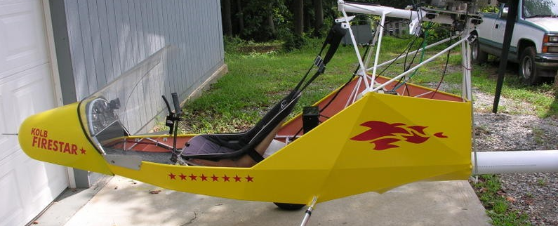

Or you could invest a lot more time, money, and effort and do one of these.
http://www.bcchapel.org/pages/0003/FSII%20seat%20page.html
