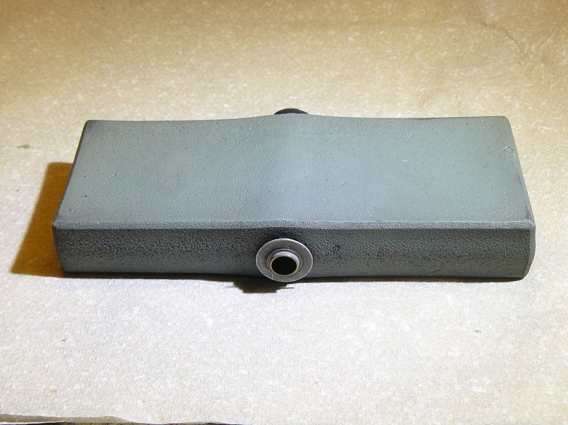

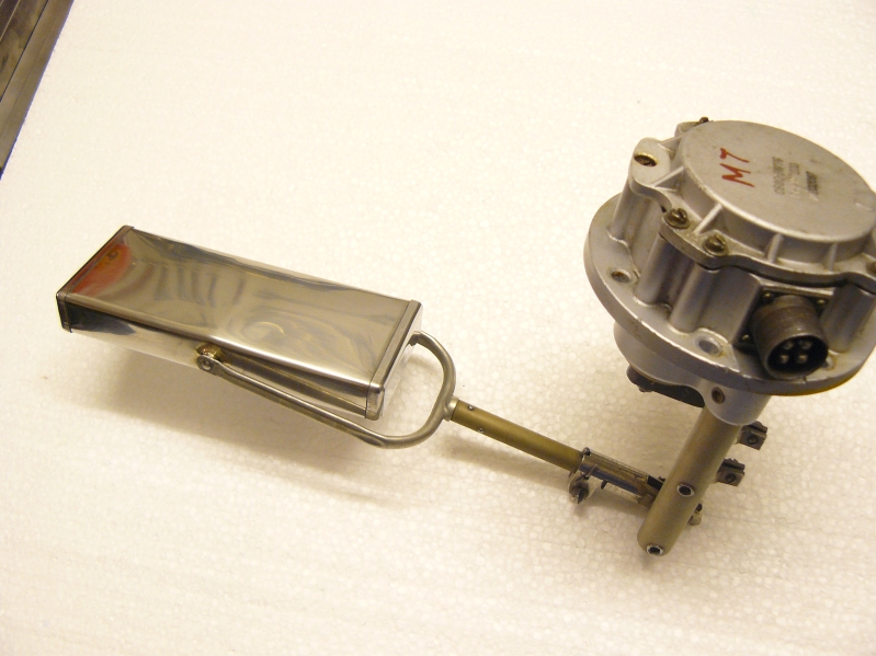

not sure if I understand the setup of your fuel system on the 18 T . But some time ago we had a sudden misreading of the fuel gauge as well, showing only 40 litres with full tanks. Then we found out that the float which is made of foam plastic material has shrunk a lot and was no longer able to float in gasoline. I then made new floats from stainless steel .2mm and soldered with soldering iron or micro torch. You´d need a special flux for stainless though. So you better pick brass sheet for copying the floats - saves you a lot of offensive language ....
