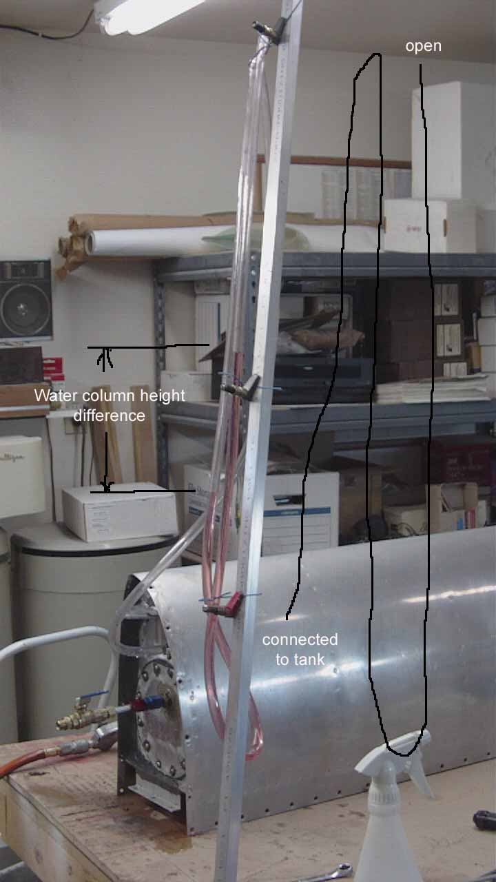

You can get way too much negative pressure with a shop vac. I would suggest
a water manometer for both positive and negative pressure as it is very
controllable and sensitive enough to show leaks. I am currently patching a
friends RV-9 tanks. Both were leaking from the root rib so the work could be
done by removing the access cover. Several years ago we patched one leaky
top rivet by cutting an access port in the back baffle so we could buck the
leaky rivet. If it had been a bottom rivet I would have used a pop rivet and
lots of proseal. I took a pic of a manometer setup for those of you that may
not be familiar with this testing setup. Doesn't have to be fancy unless you
do it a lot and don't want to jury rig time after time. Caution: it doesn't
take much air to pressurize a tank: I think there are some tables floating
around on the RV list showing how much difference in the water columns
equates to pressure in psi. To get negative pressure just lower the open end
of the tube instead of blowing air into the tank.
Albert Gardner
Yuma, AZ
PS: One of the problems I have currently encountered is uncured proseal. It
looks like not enough care was taken when mixing the original application to
ensure through mixing of the proseal.
