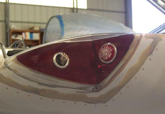

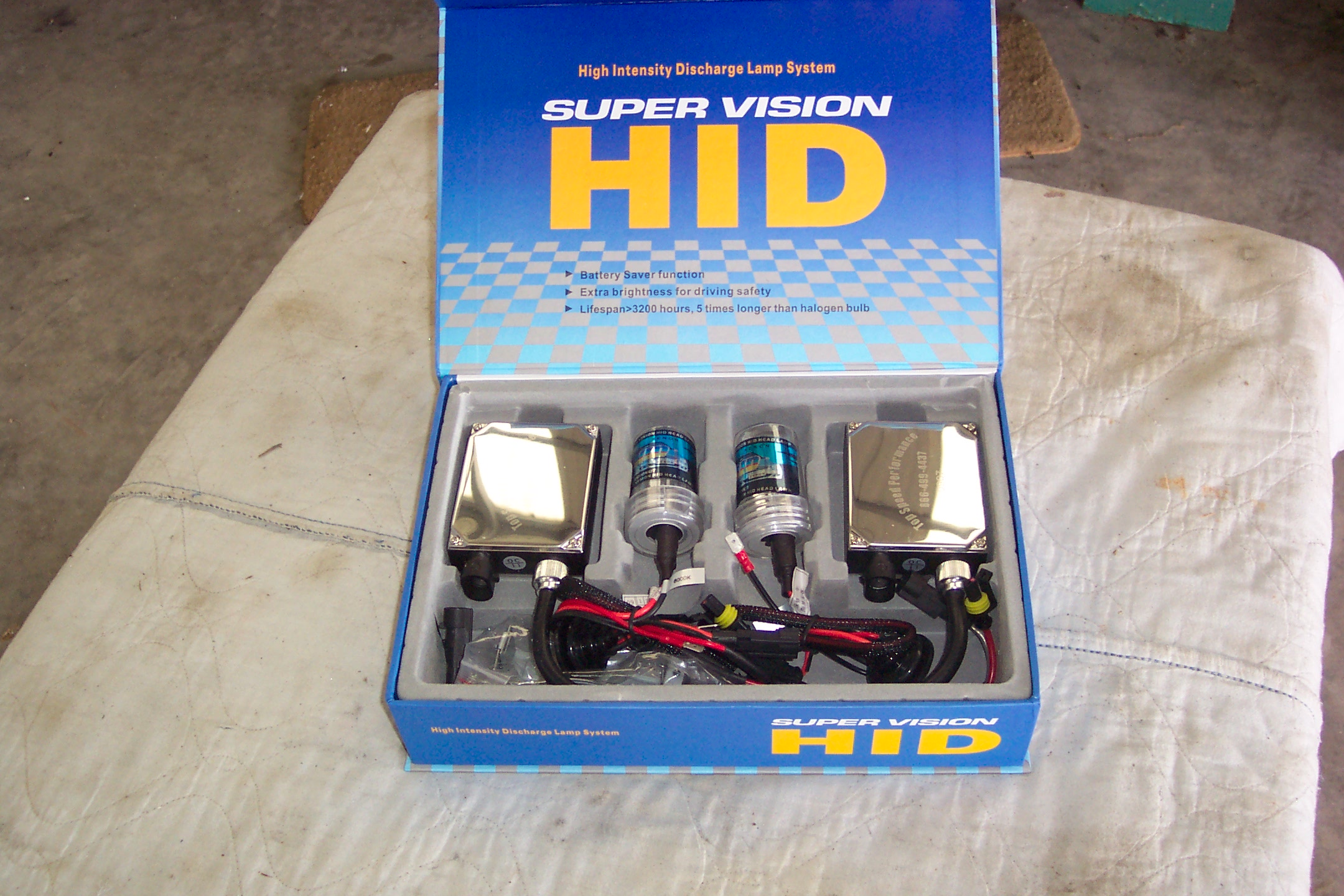

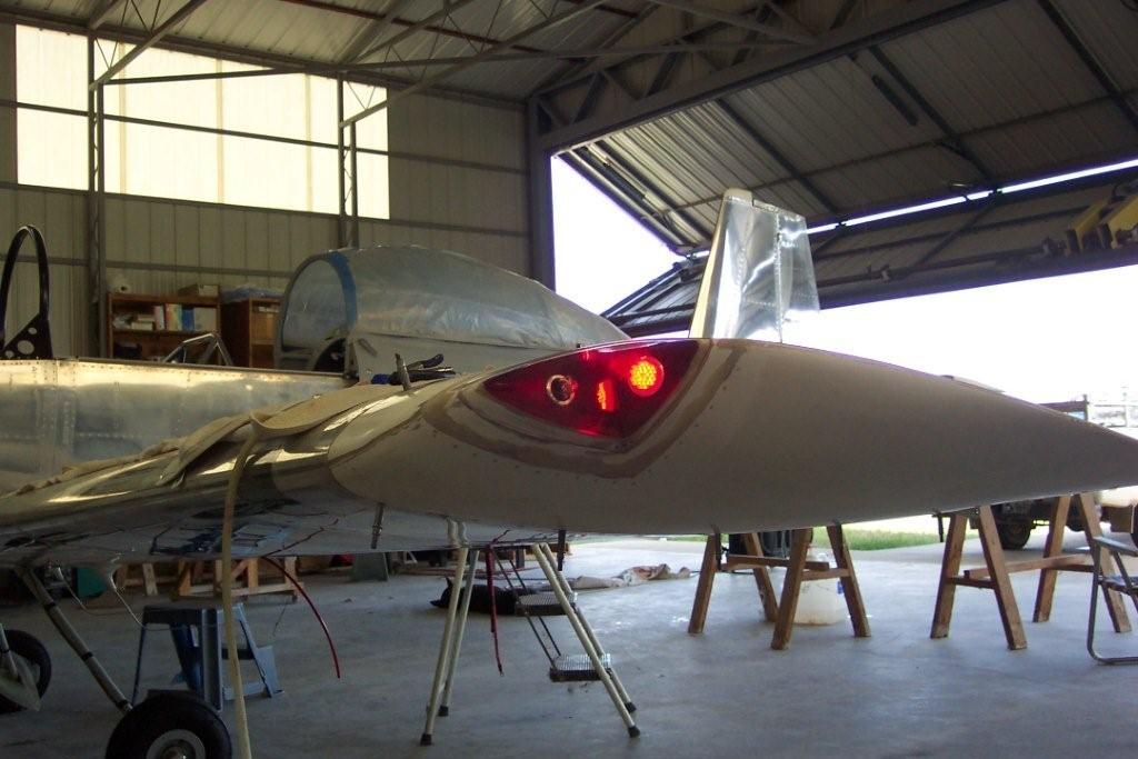

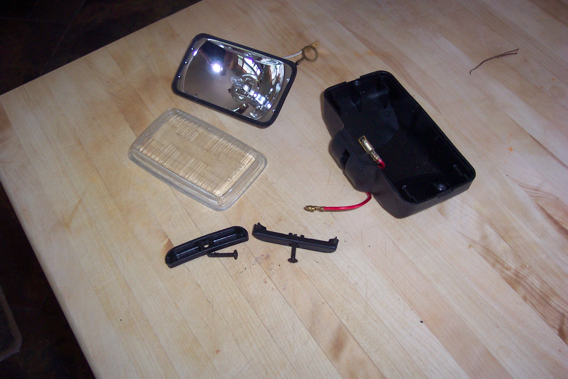

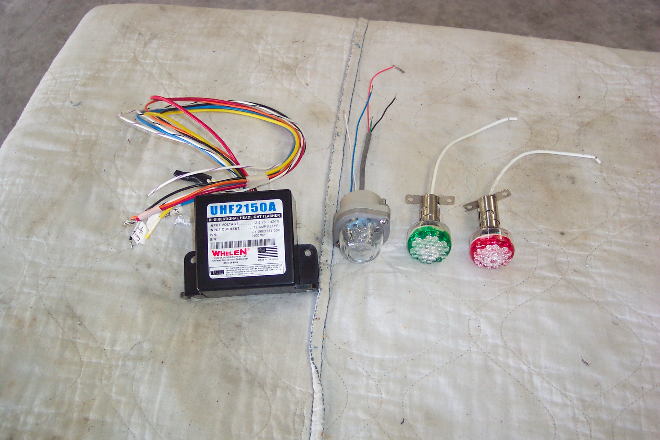

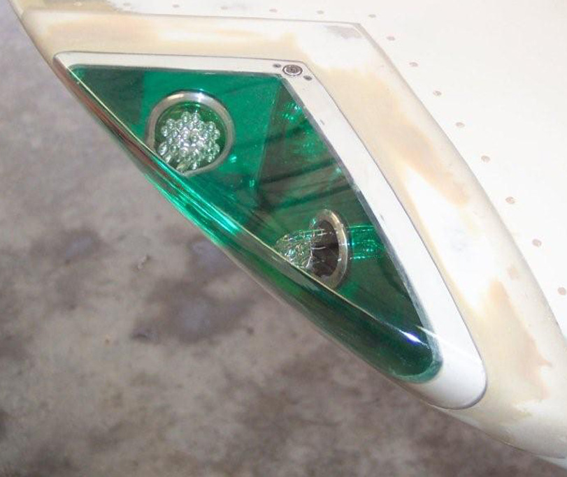

Here is what we did for my 8A Nav lights. Cost all of $40.00. Works better than most I have seen.
Green/Red LED's came from www.SuperbrightLED.com If you want even brighter (no need) then buy the LED's with more lights on the side. Connector is $3.00 automotive socket. Colored Plexi was $4.00 each from ???
HID Landing Lights came from eBay ~$70.00/pair.
Photos Attached,
Robin
