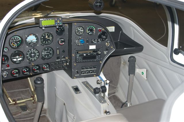

We bought F-PMLH equipped with GARMIN GTX327 and Alticodeur ACK30, which
means mode C (very efficient and easy to use).
Mode S is not (yet?) requested in France. Most are still equipped with mode
A or Mode C.
Max Cointe
F-PMLH TriGear Kit #560
912ULS Airmaster 400 hours
