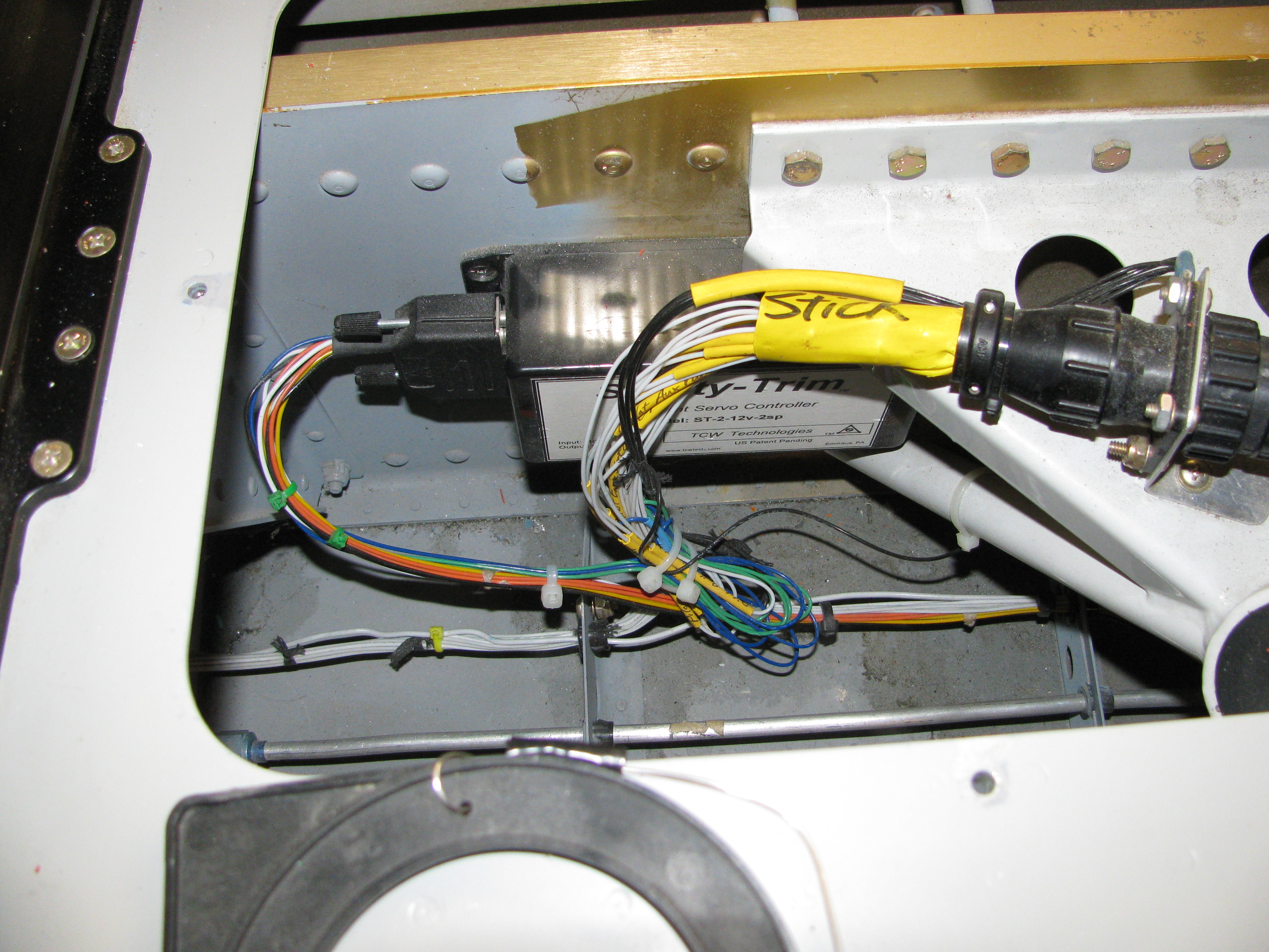

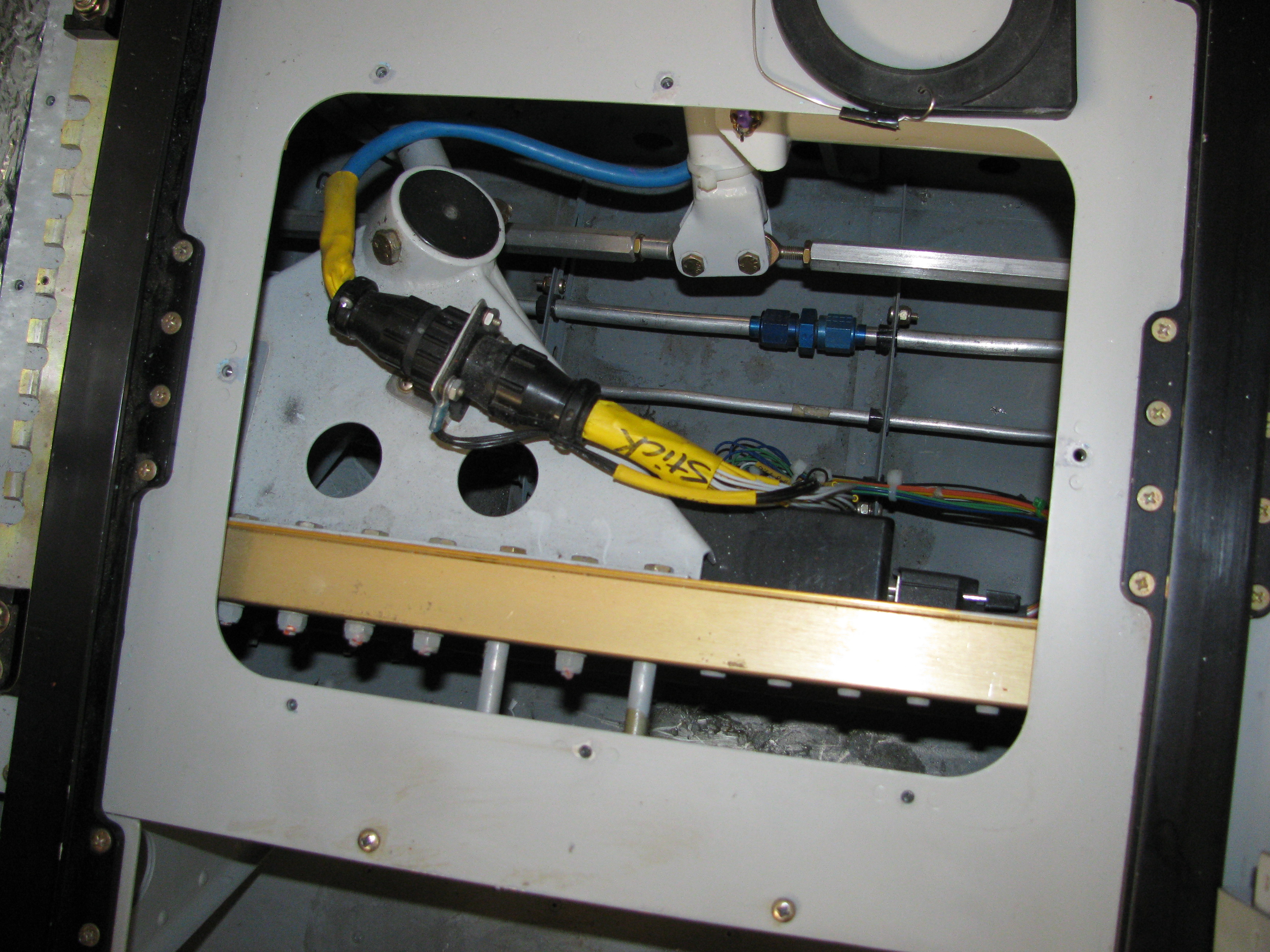

PostPosted: Wed Feb 08, 2012 5:13 am    Post subject: Drilling the Spar Web? Reply with quote
Here's where a couple of us put it. Be sure to clean up holes.

PostPosted: Thu Feb 09, 2012 1:40 pm    Post subject: Re: Drilling the Spar Web? Reply with quote
Thank you Patrick for the photos. That's is precisely the sort of thing I was thinking about doing. I asked Vans about drilling the Web and they seemed to think it would be ok as long as the holes were small and not great in number. I think 4 x #19 holes would qualify in that respect.
