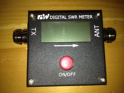

The Red Dot Digital SWR Meter that I ordered last week has arrived from China.
Here's a picture of the front:
It appears very well built with a steel(?) case.

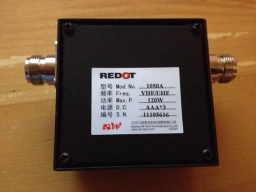

Here's a picture of the back:

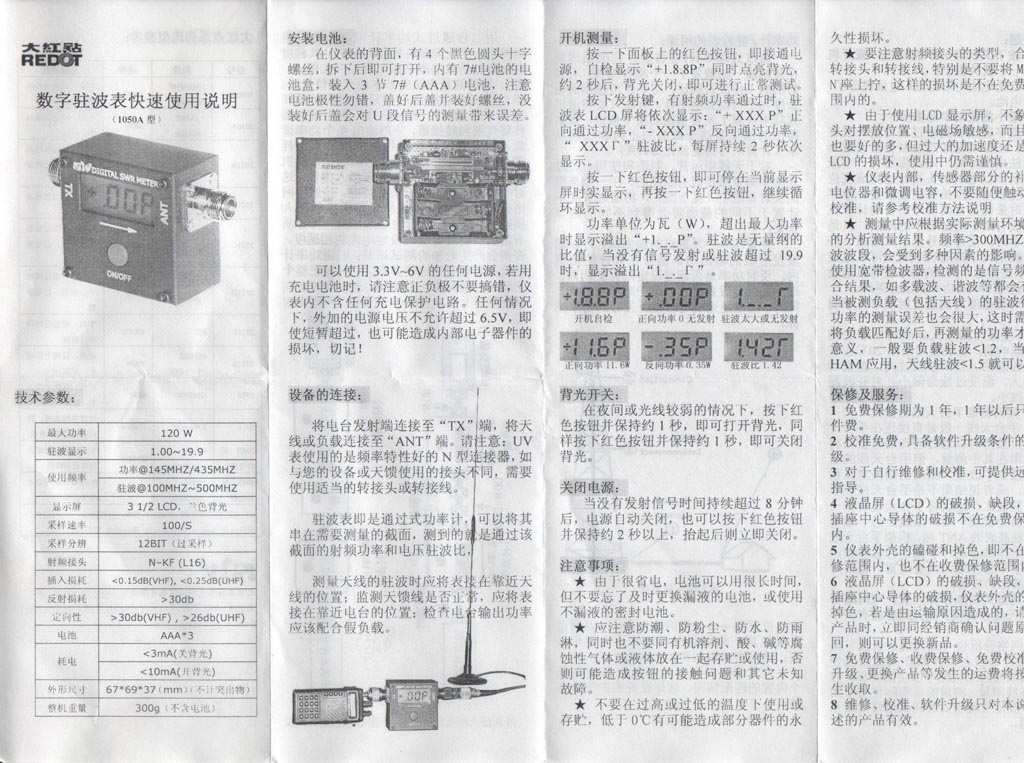

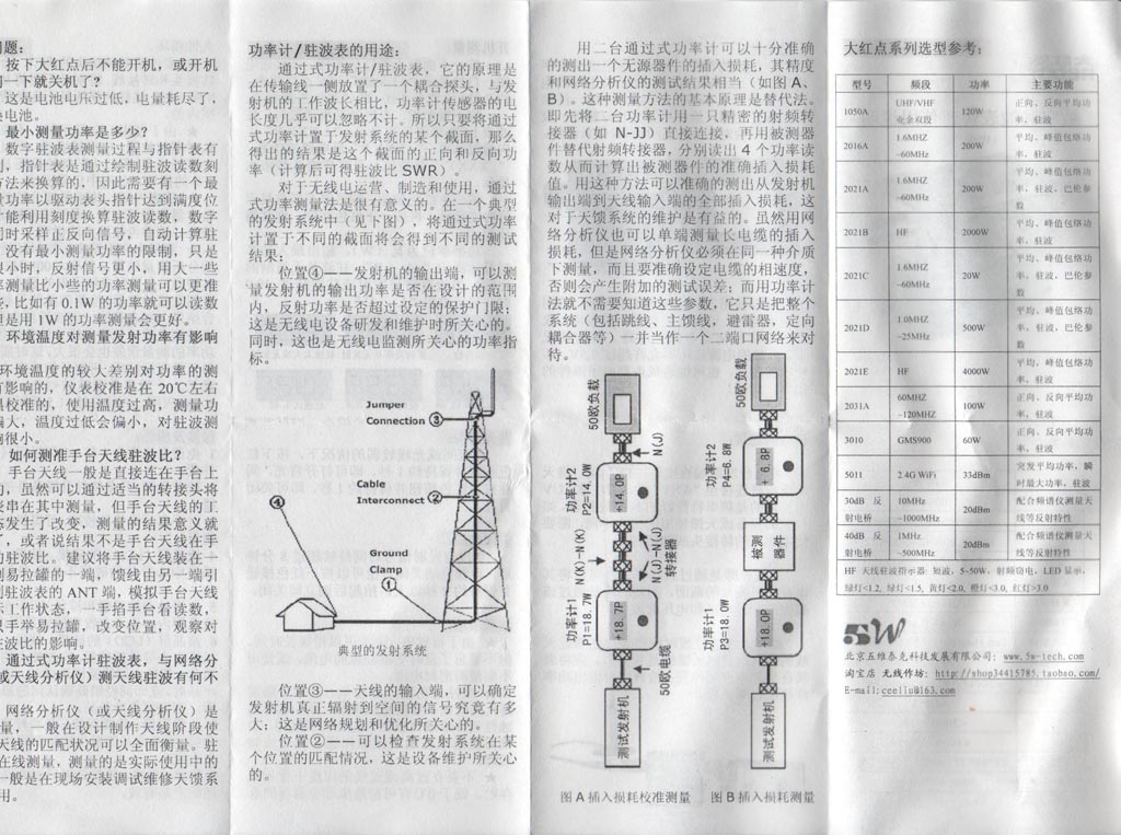

Now for the best part. Here's a scan of the instructions, front and back:
Do we have a Chinese translator in the house?
It appears that it takes 3 AAA batteries. I'll have to remove the back and confirm that it looks like the picture and put some batteries in it.
I think I'll wait until you have had the opportunity to test the one you have on order before I go any further than that.

I think mine is here too. Need to get to the PO Box in
the morning. I've looked for an English instruction
manual but nothing turned up in the time I had.
I did find this narrative by a user:
Specifications:
MAX.POWER 120W
V.S.W.R 1.00~19.9
FREQUENCY RANGE VHF(145mhz) / UHF(45mhz)
COVER:100mhz~500mhz
ONSERTION LOSS < 0.15dB(VHF) , < 0.25dB(UHF)
TEMPERATURE 0?~70?
BATTERY
3 x AAA Type Battery or Rechargeable <2mA
(battery not included in this sale)
SZIE 66*68*37 (mm)
INTERFACE N(SL16)
WEIGHT 260g (without battery)
Instructions:
Battery installation: Remove 4 black round screws on the corner of
back cover and open it. Install 3 AAA batteries. BE CAUTIOUS to the
polarities. Put the cover on and fasten the screws. IMPROPER
INSTALLATION OF BACK COVER WILL CAUSE ERROR ON U-BAND MEASUREMENT!
Connect the Output of your transceiver to "TX" and Antenna or Load to
"ANT". NOTE: UV-Band meter utilize "N" type connectors; and"SL16"
connectors (normally named "M" connecter) for HF-Band. Proper
adaptor/cable is required if your device has different type of connectors.
Press the red button to power on. After 2 seconds of LCD self test,
it's ready for normal measurement.
UV-Band meter will display in sequence:"+ XXX P" (pass through
power),"- XXX P" (feed back power)," XXX G" (SWR value), 2 seconds
display for each mode. Press the red button will hold the current
display. Press it again to continue the display.
Under the environment of night or weak illumination, just press and
hold the red button for 1 second to turn the blue back light on.
Press and hold the red button for 1 second again to turn it off.
8 minutes after no power was measured, it will power off
automatically. Press and hold the red button for 2 seconds to turn
off manually.

When you power it up, it cycles between forward
power, reverse power and SWR. You can hit the button
to hold it in one of these three readings if you're
making adjustments.
