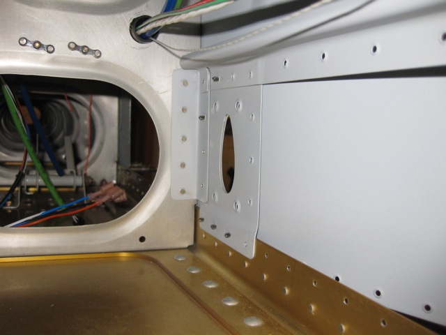

PostPosted: Fri Feb 10, 2012 4:42 am    Post subject: Pitot tube mast Reply with quote
Hi Kelly,
I just finished installing the Gretz mount for the Dynon pitot.
The Gretz kit appears to be slightly more complicated, having a reinforcing backplate riveted to the skin and spar, plus a spacer plate and most of the nutplates and bolts required (except those to join the pitot and mast). The arrangement is obviously heavier (steel mast, more parts) but perhaps more robust (no cracking history). The mast is removable for storage and painting if wanted (eg. with the chrome mast) and is not in place when you rivet the bottom skins on. The mast is bolted afterwards to the reinforcement plate inside the wing.
In consultation with my tech advisor I also added an additional length of J-stiffener along the back edge of the reinforcing plate to reduce skin flexing under load. Altogether it became a little complex (perhaps over engineered) but it shouldn't fall off…. Smile
Cheers,
Gordon
