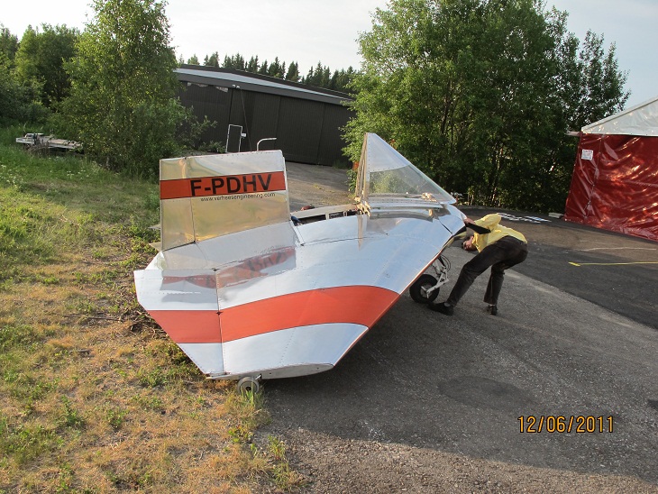

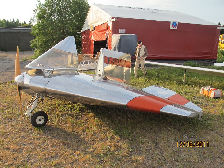

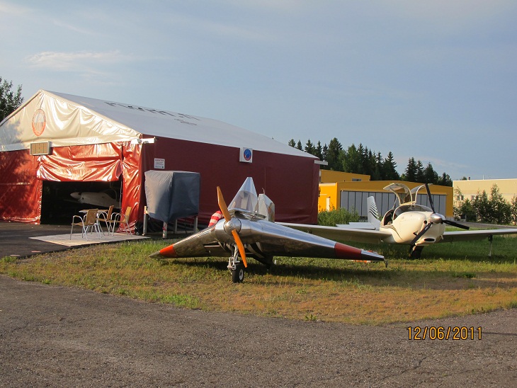

Max
Laurent have to be a real fast builder: KIT # 560 and completed 2003. I have a KIT # 417 and completed 1999 – 2007. I assume he build it only a year or two?
I wrote “French James Bond “ because I do not believe original JB is not so brave he could separate by purpose Europa´s door during flight (like you did but one only). Now I know – he will be OSS117. I assume you are OSS116.
Welcome to Finland – F-PMLH would be 2nd F-registered Europa in EFTP (attachment).
If you are going to fly w/o doors, I recommend you to come when midsummer...

Raimo,
Do you talk about the flying metal wing on the picture? I saw it during convention of home built planes in Blois but didn’t met the guy ! Impressive indeed.
Laurent had a partner to help him and they spend together 2700 hours to build F-PMLH over 28 months. Amazing, I don’t when or even if he was sleeping at night assuming he was at the same time manager of a restaurant in Rueil Malmaison…
For sure it wasn’t intentional to leave the door during take-off. And there is a couple of movies on OSS 117 who is a stupid basic macho… I hope I’m not
Even with the two doors closed, I won’t come (if I can make it) in winter or cold weather.

Max
Raimo

PostPosted: Thu Feb 09, 2012 8:27 am    Post subject: Europa-List: Pip-pins in the Europa´s doors - more safety o Reply with quote
Max
I do.
It is F-PDHV. A man who is looking a minor problem in the nose gear is the designer /builder /pilot Bart Verhees.
With a small Subaru engine it cruises 160 mph = 140 kts = good company for Europas.
First time ever I saw a situation the men from tower came out and wanted to take pics about a flying machine.
When seeing airborne, nothing is nearer an UFO than this one.
http://www.verheesengineering.com/pix/delta001.jpg
Other man is Mr. Karel Vranken, Europa F-PKRL builder /pilot.
I do not know a real reason but everybody wants to visit us. So we get some air traffic here and see many IFOs (interesting flying objects) like this Delta, Europas, AN-2, DC-3, Rotorway Exec, Lancairs, countless amounts of seaplanes, skiplanes and amfibios´s. The sugar on the bottom is so far Casa C-295 15th of August 2010.
Raimo

Raimo,

Raimo,

Max
Raimo
