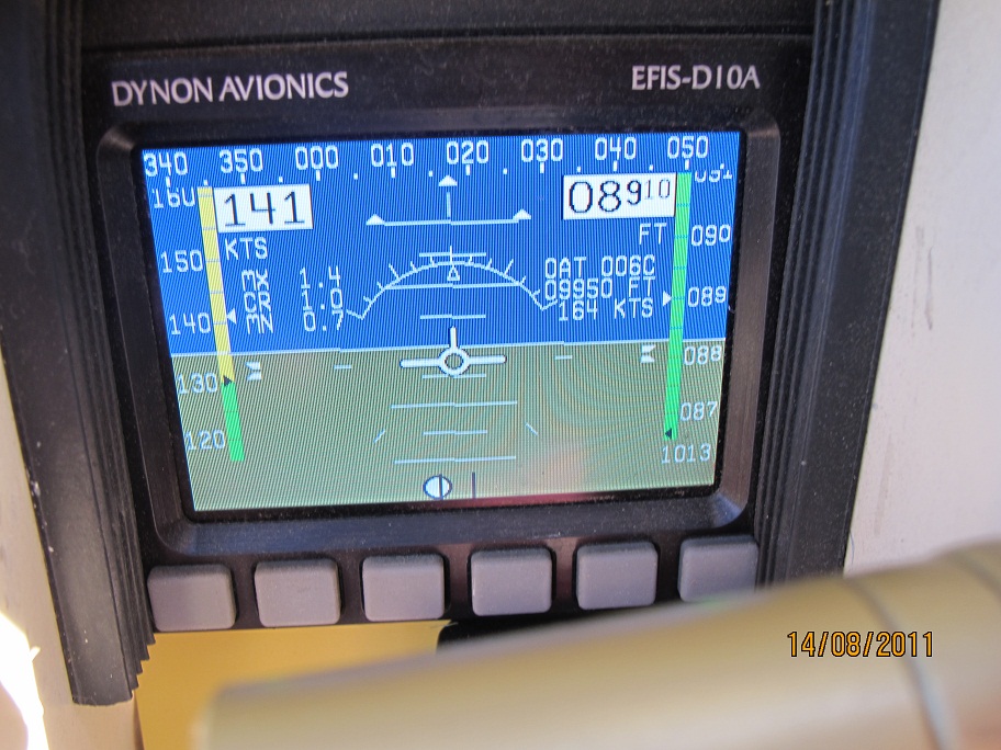

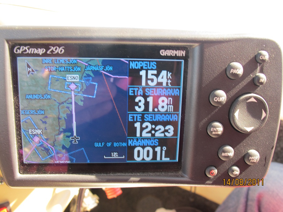

I have calibrated it carefully. Flying a triangle
and counting an average speed. Or flying when zero
winds and compareing to GPS.
Also, I give my panel when new to The Finnish
Airforce´s Tech and they put it to the test bench
to calibrate & adjust ALTs, Varis, ASIs, ALT
Encoder, xpdr, radio etc. (attachment).
Last summer we had a nice trip to Siljansnäs.
Look at first pic: my wife is piloting w her left
hand and writing some notes and talking with ESNO
twr, GPS has 154 knots (notice also; her door is
secured by pip-pin. Awful - she cannot escape!).
Second pic: heading to north-north-east, GPS still
154 knots.
Third pic: Dynon shows HDG 17 degrees, IAS 141
kts, TAS 164 kts, practically level flight, wind
was from south 10-15 knots.
We typically cruise IAS 140 knots.

A little left rudder and you may pick up a couple knots:)
Cheers, Kevin
On Feb 7, 2012, at 11:59 AM, "Raimo Toivio" <raimo.toivio(at)rwm.fi> wrote:
Second pic: heading to north-north-east, GPS still 154 knots.
Third pic: Dynon shows HDG 17 degrees, IAS 141 kts, TAS 164 kts, practically level flight, wind was from south 10-15 knots.
still 154 knots.
