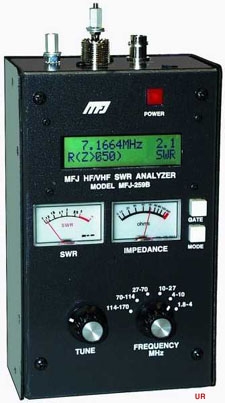

Generally, yes. Most 'stand alone' swr instruments need some
form of stimulation at the frequency of interest.
If the above is correct how does one match nav radios to coax and antennas
You find another signal source that will excite the
feedline and antenna at the frequency of interest -OR-
you use an instrument that features a built-in signal
source like . . .
[img]cid:.0[/img]

The MFJ-259 pictured above is the grand-daddy of
antenna analyzers. It will tell you everything you
need to know about the antenna system. Proble is,
they're kind of pricey. I think I bought my first
one about 10 years ago for under $200. They're pushing
$300 new
http://www.mfjenterprises.com/Product.php?productid=MFJ-259B
You can find them for a little less on eBay but
not much.
Another possibility is this little gem offered
on eBay and elsewhere:
http://tinyurl.com/7cl4bba
I've got one on order for evaluation. If
you don't have access to a capable VHF antenna
analyzer or swr bridge, these two options are
worth considering.

This is a self contained antenna analyzer. It features
a variable frequency oscillator that provides a test
signal source over a 2 to 170 Mhz range. There is a
counter that displays the oscillator's present frequency.
Finally, there is an array of detectors upon which a
ratiometric analysis is conducted to deduce the resistive
and reactive components of the antenna and display them.
Instruction manual can be found here:
http://www.mfjenterprises.com/pdffiles/MFJ-259B.pdf
While not a laboratory grade instrument, it's
a lot of bang for the buck.

Once you have an MFJ259 in hand, you can both
trim overall length of the Archer design to
desired center frequency, you could also adjust
the gamma-match and tuning capacitor for optimum
performance too.
