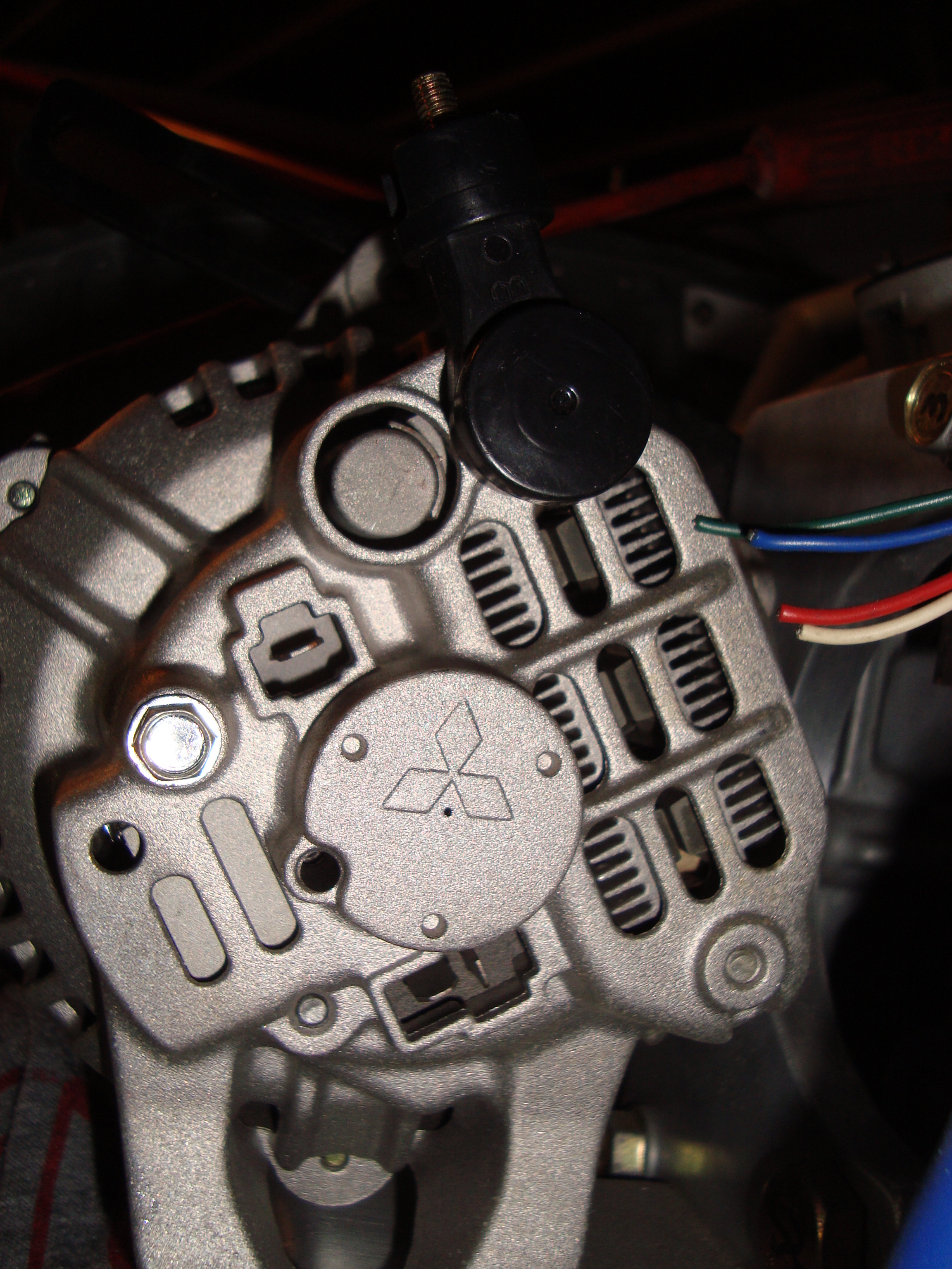

I have appreciated all the information received during the last year or two as I have been preparing to wire my panel. The time has come. I have a question regarding the wiring of my alternator, a Bosch AL394X. I have tried to find wiring schemes on the internet, but have not been able to download what I need. I have included a picture to help. At about 12 o'clock, I assume the large, black connecter goes to the battery. What should be done with the connector plug at about 10 o'clock above the center hub and the two connector plug at about 6 o'clock below the center hub? Thanks for your help!!! Ken Johnson

At 09:23 AM 2/4/2012, you wrote:
Bob and All,
Yes
What should be done with the connector plug at about 10 o'clock above the center hub . . .
Leave it open
Ignore the "lamp" connection. Connect your control
input wire to "IGN". Do you have a plan for dealing with
an OV condition?

At 12:23 PM 2/5/2012, you wrote:
Bob, thanks again for your help. I have an EXP-Bus that I am using
and in which I can connect for OV protection. Does the 10 o'clock
connection go to this bus?
The data was not helpful about the upper-left terminal . . .
given that it's an internally regulated alternator, I
haven't even got a good guess as to what that terminal
is for.
At 70A, it's certainly a robust alternator. But without
adding a b-lead disconnect contactor, this style
of alternator many not be controllable from outside
during a runaway OV event. Suggest you consider modifying
it for use with an external regulator, ov protection system
friendlier to airplanes.
