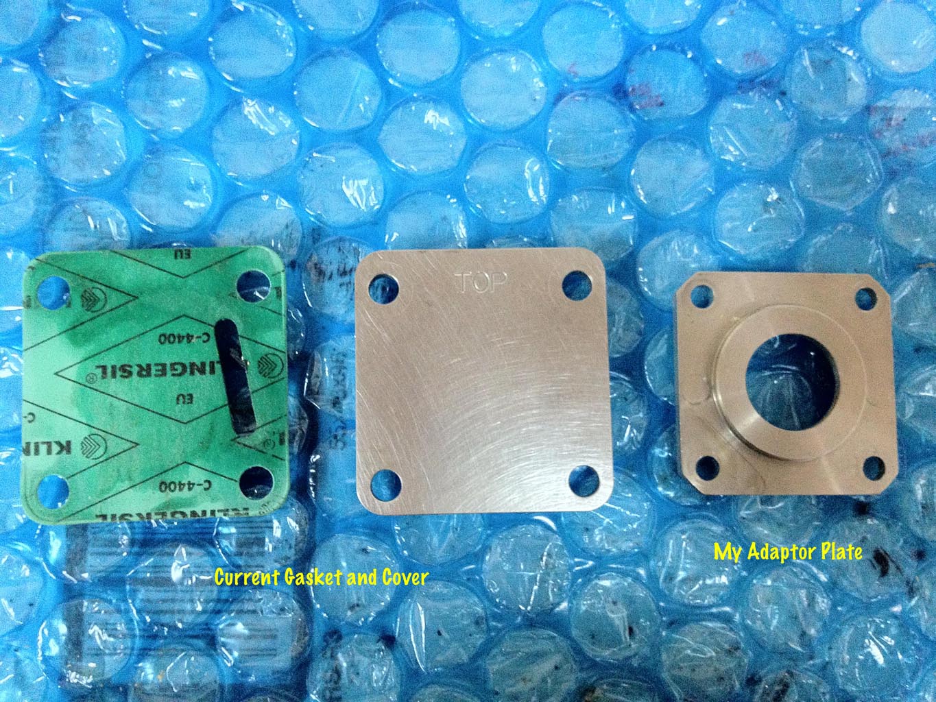

I had an alternator on that pad and recently removed it. There was a cover on that pad but in the building years, I have misplaced it. So I called Lockwood Aviation to obtain a replacement cover. They had just removed that cover from a new engine and send the cover and gasket to me free of charge. (Great folks at Lockwood!) The new cover and gasket arrived but it didn't fit. Seems they have changed the configuration of that pad sometime in the last 10 years. Here is a picture of the new plate and gasket along with the alternator adaptor plate that came off my engine:

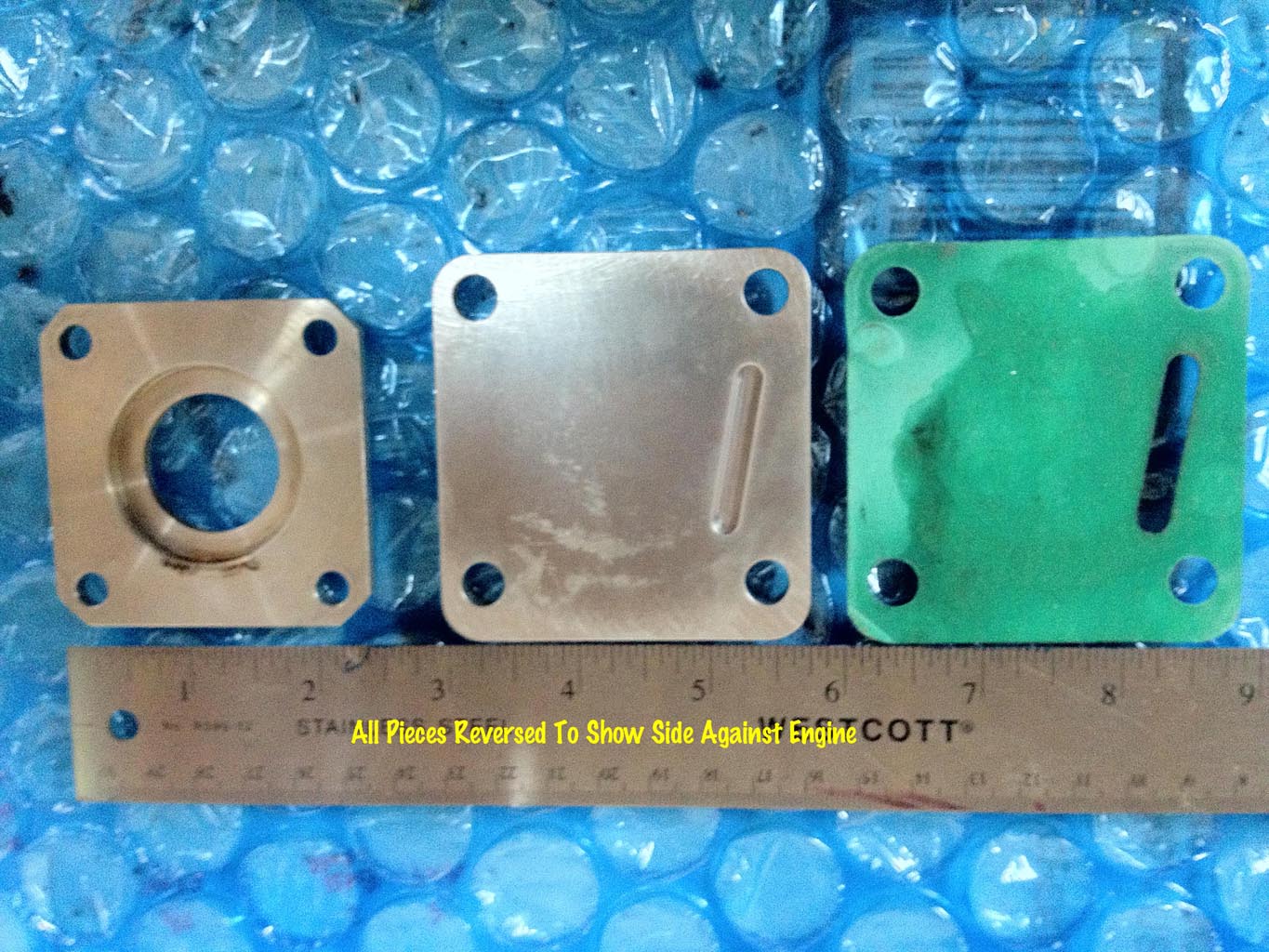

I turned them over and added a ruler so you can get an idea of the sizes:
As near as I can determine, the old cover plates are no longer available.
If your engine uses the new, larger, cover plate, I'll be happy to send the new plate and gasket to you or you can contact your local Rotax dealer to see if he has one lying around that was removed from another engine.
If your engine is older, like mine, you can still check to see if an older plate is available. If not, perhaps you can do as I did and make one up from aluminum bar stock:
That's a piece of 1/4 in aluminum bar stock cut to shape and drilled using the adaptor plate as a template. I also made up a thin silicone gasket to go between the plate and engine.
I hope this helps.

PostPosted: Fri Feb 03, 2012 10:17 am    Post subject: Re: Cover for the vacuum pump mount necessary? Reply with quote
Bob, your support is outstanding, thank you so much!
I have got the removed vacuum pump here in my house.
The bolt holes are 4,7cm ( 1,85 inch) apart (center-center).
Seems my mount has got the same size as yours.
May be, they send you the wrong cover especially I am not sure what the grove in the plate and the gasket should be good for.
But looking at the pictures you made I now have got the idea to close the adapter plate and use it as a cover.

PostPosted: Fri Feb 03, 2012 11:18 am    Post subject: Cover for the vacuum pump mount necessary? Reply with quote
Hi Jurgen,
When I spoke with Trisha Lockwood, I used the part number for the cover and gasket directly from the current Rotax Illustrated Parts Catalog. 926231 for the Cover and 931770 for the Gasket. And the parts in the illustration look just like the parts sent by Lockwood. Normally these parts are not fastened to the studs with nuts and washers. According to the illustrated parts catalog, the cover and gasket are usually held in place with 4 Allen Screws (M8x20) 240071, 4 Lock Washers (ACool 945752 and 4 Flat Washers (8.4) 250311. BTW, the cover plate provided by Lockwood was 6mm thick (~ 1/4 in), so a 6mm or 1/4" plate should be correct.

PostPosted: Sat Feb 04, 2012 4:22 am    Post subject: Cover for the vacuum pump mount necessary? Reply with quote
David,
Yes, a simple alloy plate should do. The fancier plate and gasket provided by Rotax seem to be most useful it you are removing prop governor. In which case there is an oil channel required on the cover plate which completes an oil passage on the governor adaptor.
