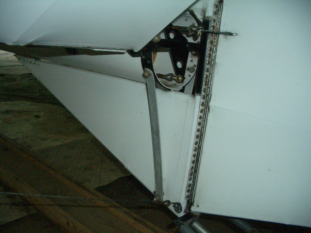

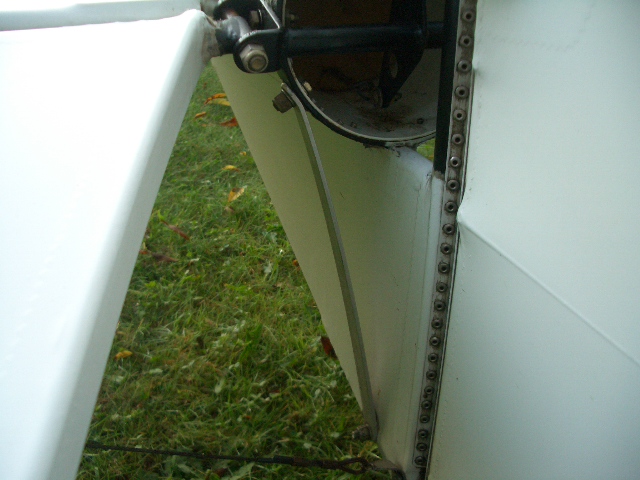

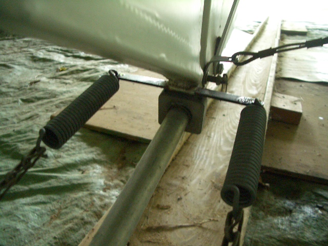

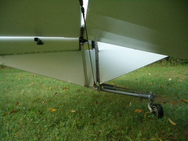

The tail wheel spring slides into the steel tubing of the tail post assy.But that tube is only about 3-4" long and a piece of aluminum tube is riveted to it and goes up the rest of the way to the fuselage tube.That aluminum tube has more than likely broken at the end of the steel.The twisting loads that the tail wheel puts on this assy. when you turn sharply does this.Grab the vertical fin and shake the tail side to side and you can see this .John Hauck made a nice fix for this issue and a lot of us have made the modification .I have a picture or two. G.Aman

Gary I put the tail wheel spring clamp from JBM that you suggested on my plane.It's amazing how much it tightens up the tail wheel spring in the vertical stab.Also installed Johns vertical stab braces.Sure strengthens side motion on the Mark 3.The list is certainly a wealth of knowledge.
