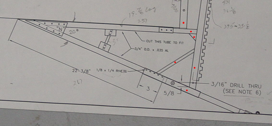

I copied part of page 4 of the FireFly assembly book, and I have sent it as
an attachment.
To help explain the assembly, I marked all of the steel welded components
that make up the boom tube attachment ring and vertical stabilizer post with
a red dot. All components not marked are assembled aluminum parts.

Re: the tail wheel assembly, the photos and blueprints are a world of
information. Now I can probe thru the fabric and know what should be
where doing what, making it pretty simple to figure what is happening.
Also, Gary's description of tight turns torquing the assembly gave me
some insight. Second last day I went up was right after quite a bit of
rain. I thought the only unwanted result was a lot of muddy slop thrown
on the bottom of my wings and tail section, but knowing the effect of
tight turns gave me a gestalt moment. My FF is hangared in a converted
