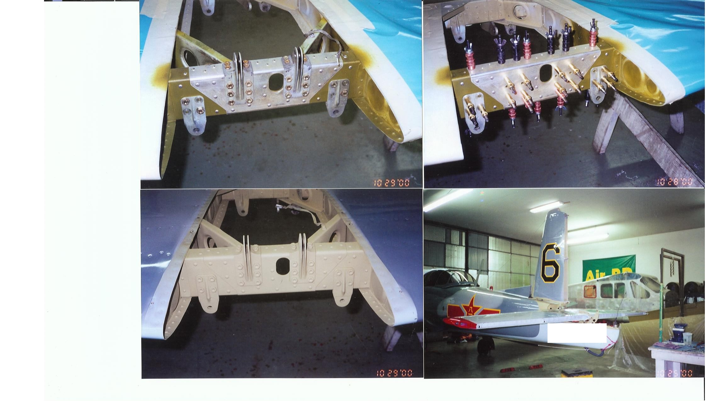

This condition was detected and addressed back in 1995, possibly before. My CJ as well as three in the same shipment, owned by Alan Beaver and Bill Thornberry, all had similar cracks. A California DER engineered a fix which was accepted by the FAA. It consisted of a doubler made from 4130, bent to fit the inside of the spar and affixed with bolts through the spar. I went a step further and added 2024 ribs on each side to help spread the load so stress was not merely shifted to the spar just outside the doubler.
Many other CJ's were repaired in this manner. Eleven hundred hours later and no additional cracking. Old news, I'm surprised someone found an airframe without the repair. *Every* CJ mechanic should be aware, it was documented numerous times.

Craig,I think we may have had this discussion before, I can't recall for sure, but you are correct in that an fix was engineered, but rather it was actually "accepted by the FAA" is up for debate and really does not matter.  It is in my opinion a very poor fix indeed, it simply makes the center of the spar so stiff that it cannot flex, the result is that it effectively shifts the stress the the edges of the doubler as you have correctly stated.  If in fact a DER actually engineered this fix he needs to get back to his most basic directives and re read 41-13-5.  It would NEVER suggest using an spar doubler of that strength on a alu structure, in that position, let alone something made of 4130 chromemoly sheet.  I will admit the solutions are very limited and the basic idea of a U shaped reinforcement with a doubler plate on the back side is most likely the best way to effect the repair but IMHO the reinforcement and the doubler should be no heaver than .040 2024-T3 aluminum, NOT 4130 steel, no not even stainless steel.  The structure is made to flex, it cannot flex if you use steel.  Yes we have had no failures using the "engineered" fix, but that does not mean the fix was done correctly, it simply means we have not had any failures yet.  I have done several with the alu and they have not failed either..................
Yes, you are right Doug. We had this discussion on here when the list
was first started. I remember suggesting that the doubler transfers
the stresses to the spar at the end of doubler, just moving the
problem rather than solving it. I suggested a tapered or laminated
doubler so that the stresses are transferred gradually from the
doubler to the spar along the length of the doubler.
OTOH, since no one seems to be seeing new cracking at what appears to
be the new stress point at the end of the doubler, we have solid
empirical evidence that there isn't a problem with the current doubler
design. So even if it appears to be a poor design, the evidence
suggests that it is working OK.
At this point I think I am going to come down on the side of, "if it
ain't broke, don't fix it."

samira.h(at)shaw.ca
PostPosted: Thu Jan 26, 2012 10:56 am    Post subject: Tailplane front spar crack Reply with quote
Please see attached picture.
cheers
Elmar
 Filesize:  702.79 KB
 Viewed:  7191 Time(s)
