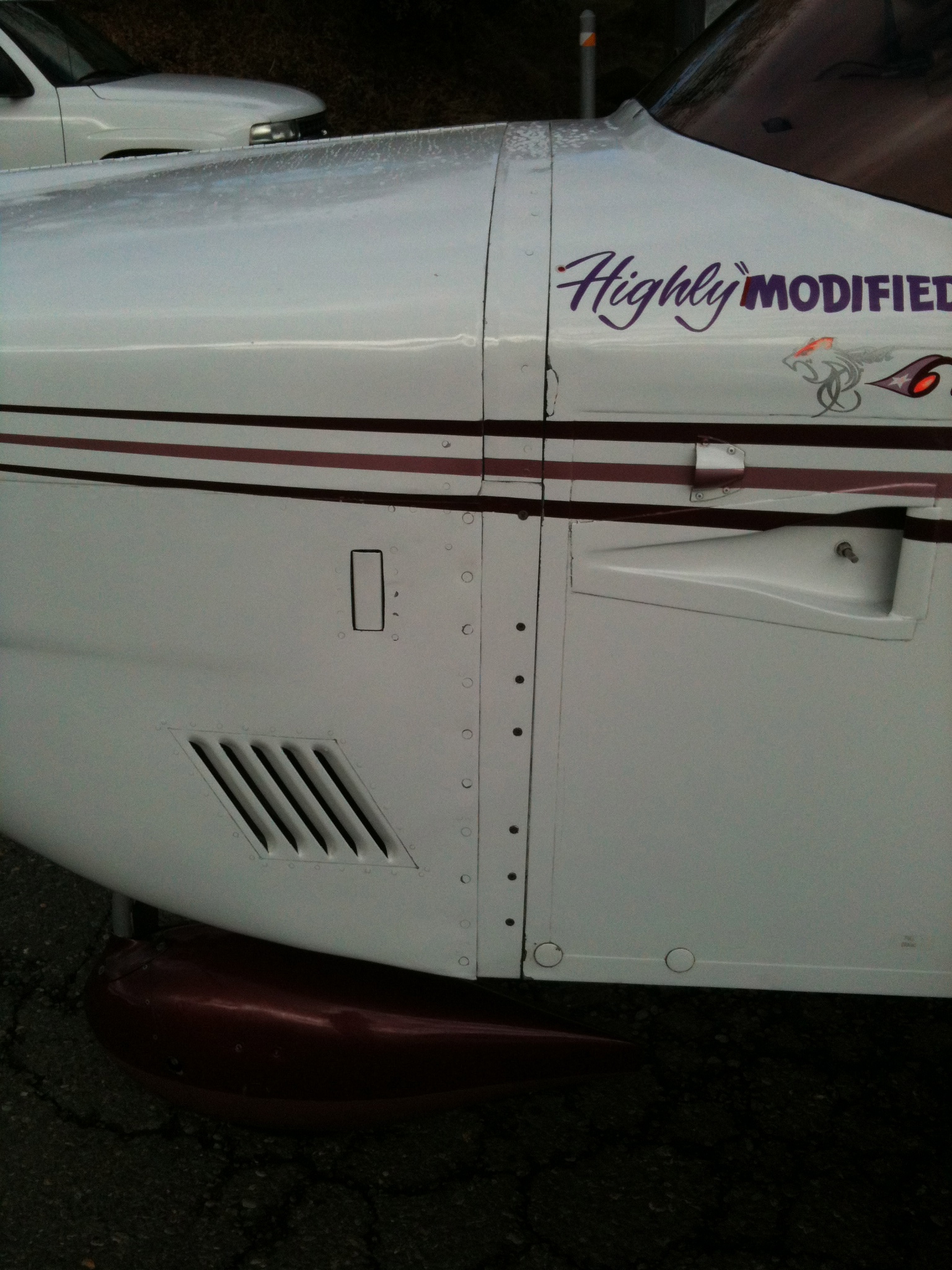

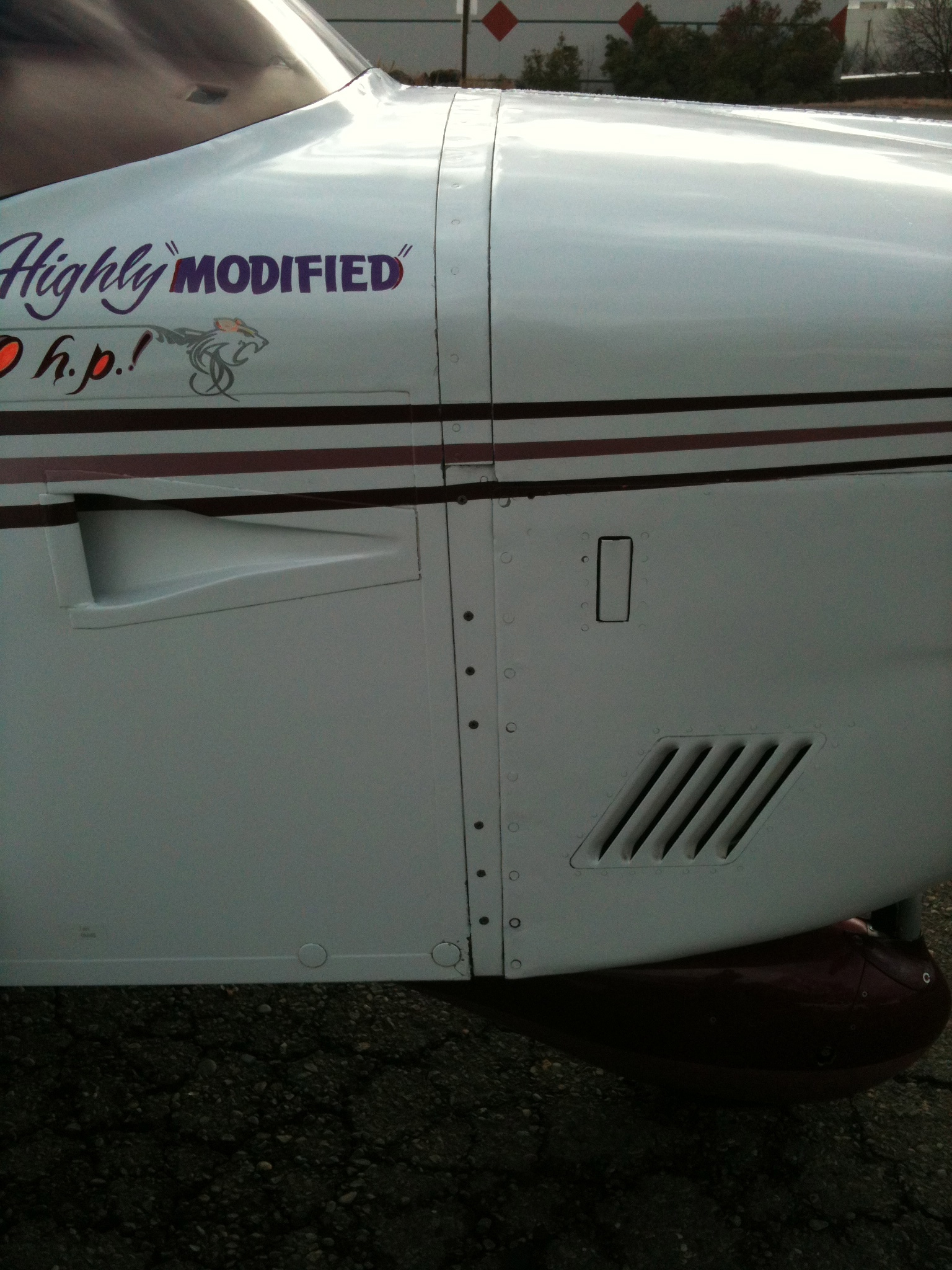

I've been doing some work on Papa John's 6-cylinder Cheetah. I noticed the cowling alignment and the change side-to-side. His down thrust is measured at about 1 to 1.1 degrees down.

Is that good or bad? The spacer between the fuselage and cowling is
tapered (wider at the top).
Cliff

The engine needs to be down to reduce the need for trim when changing power.
