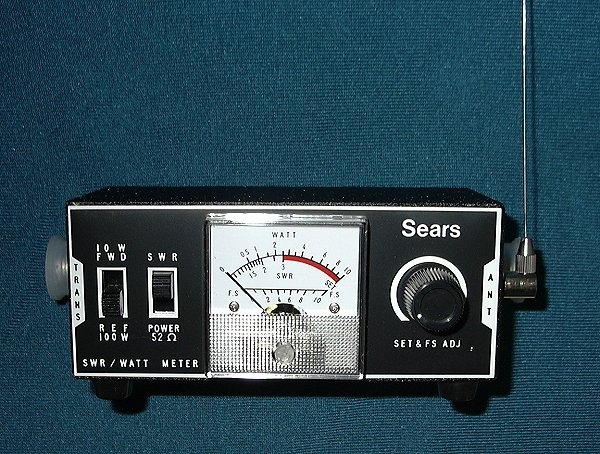

At 12:57 PM 1/21/2012, ROGER & JEAN CURTIS wrote:
I have a Vintage Sears SWR / FS meter which appears to be
the same as the Cal Com Model 9856. Can this be used to check the antenna
on aircraft nav com radios? If so, how do I set it up for use?
Roger
This is no doubt an excellent example of a
directional coupler sampling reflectometer. Dozens
of products of this genre' were manufactured
and they are quite common.
[img]cid:.0[/img]

They are quite effective over the range of 2 to
perhaps 30 MHz. To be useful, the length of transmission
line inside must be a small fraction of a wavelength
at the frequency of interest. In this case, 126 Mhz.
When you study the design of a Watt/SWR meter suited
for VHF . . .

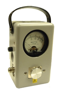

The sampling is in a single "slug" that can be
rotated to present complimentary forward and reverse
power samples.
[img]cid:.2[/img]
The slug contains a miniaturized version of the directional
coupler sampling sampling loops found in your SWR meter.
Here's a photo of a miniaturized version of your SWR meter
optimized for VHF/UHF service. The loops are about 1/2"
long.
[img]cid:.3[/img]

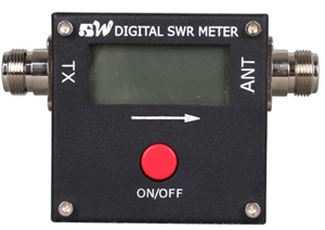

antennas. Something like this
[img]cid:.4[/img]
which can be had for about $60 off eBay. It's optimized
for VHF and will produce more useful readings.

WRT the SW DIGITAL SWR METER shown below.
It looks like a pretty cool little device that anyone could have in their OBAM tool kit. And there are sure bunches of them for sale on e-bay.
It appears to have threaded (TNC?) connections. Would one make up short lengths of BNC to TNC coax to connect it into the antenna line? Or are there BNC/TNC adaptors that are more appropriate?

I noticed on Ebay that these come in
several different flavors, various power output, and some specific to a
particular radio.
For our OBAM purpose, are there any specs to
adhere to, other than VHF band?

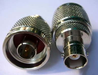

At 08:06 AM 1/22/2012, you wrote:
Bob,
Those are type N connectors. You'll want some
N-male/BNC-female adapters to make the transition
to connectors popular with the aircraft world.

I have a Bird 43 and don't need one of these for
my own purposes but I would like to put my hands
on one to compare with the Bird. As a teacher
it is always good to be able to say, "been there,
done that."
