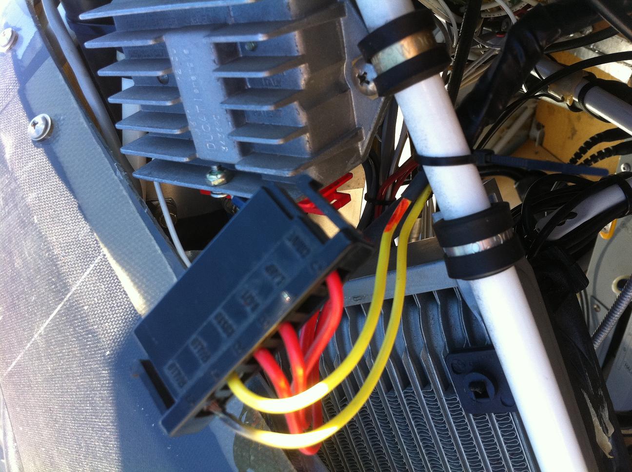

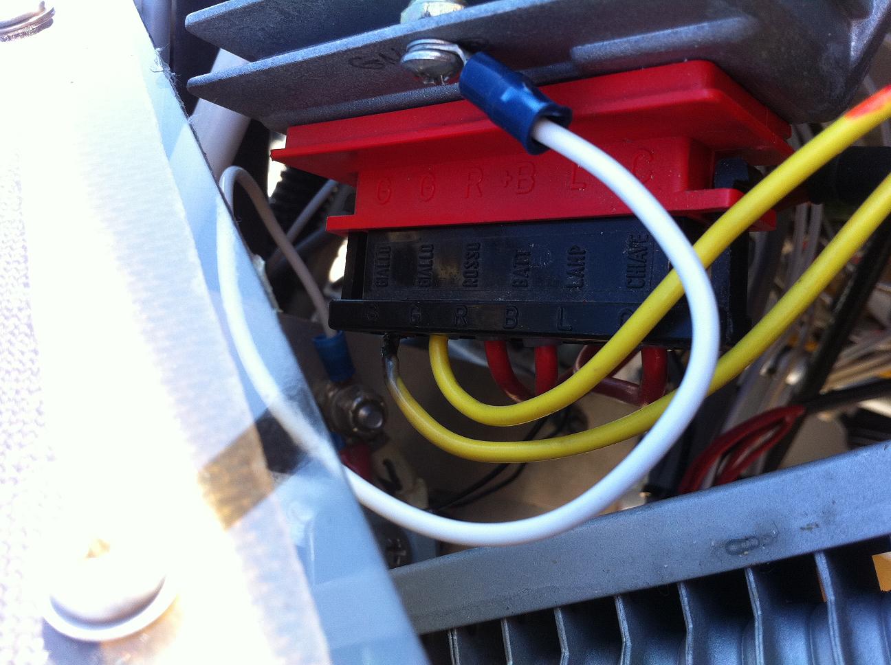

I had a forced landing today due to smoke in the cockpit. Fortunately I was nearby the airport and landed safely after shutting down all the electrical. After removing the foam donuts that my butt cut out of the seat pads, I started troubleshooting. I found that one of the wires from the coils/alternator where it goes into the regulator was fried.

Thanks for the follow-up Jerry and the pictures. It would be interesting
to have the old cut-off terminal to examine. It MIGHT have been a failure
of the fast-on terminal's grip on the tab but from your description of
the crimps, failure at the wire-to-terminal connection seems more likely.
In any case, peering at it under the microscope would still be an
interesting exercise.
As we discussed on the phone, if the new crimp tool you've purchased
specifically covers "PIDG" terminals, then you're good to go with
an inspection and perhaps some replacement of existing terminals.
