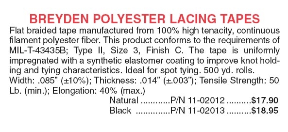

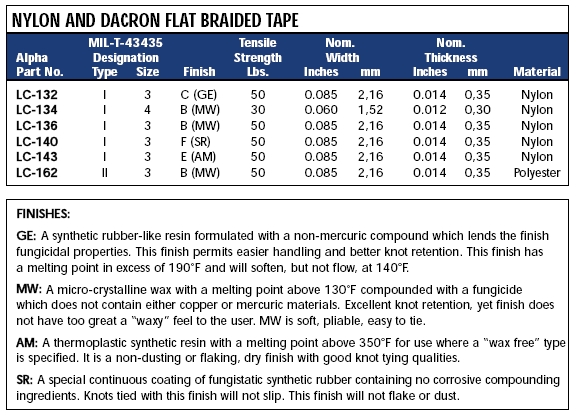

PostPosted: Sun Jan 15, 2012 9:28 pm    Post subject: Wire Bundle Wrapping Tape? Reply with quote
At 09:39 PM 1/15/2012, you wrote:
My preference is the wax cord but as with a lot of things it does take some practice to get to install it properly. It has other pluses over the nylon tie wraps You will never slice a hand open while rooting around in an engine bay that has coraseal and wax cord used. I am one of the ones who has received my fair share of slices on tie wraps.
Here's a link to a tread on the topic a few years
ago:
http://tinyurl.com/7a89njo
The "waxed cord" commonly found in military and domestic
production aircraft is probably Mil-T-43435 as described
below in the Aircraft Spruce Catalog
[img]cid:7.1.0.9.0.20120115231115.046192d8(at)aeroelectric.com.0[/img]
. . . and the Braden
[img]cid:7.1.0.9.0.20120115231115.046192d8(at)aeroelectric.com.1[/img]
 Filesize:  118.07 KB
 Viewed:  17058 Time(s)
 Filesize:  190.87 KB
james(at)etravel.org

rib lacing cord to tie wire bundles? The answer would
be certainly. Use the flat-lace described to tie
fabric to ribs? Don't know. I'd be inclined to
stick with the legacy, 'been there, done that' materials.

This sounds a lot like rib-lacing cord. Â Is that an acceptable substitute?Â
 Not sure which direction the substitution is taking
 place. Are you asking if you can use the recommended

I was wondering if there was anything special about the electrical
type that would preclude me from using the spare flat waxed rib cord
I have -- it came on a reel with about 2 miles of cord, so there's
quite a bit left over from when I did the covering!
Thanks for the advice.
I think that's a safe substitution. In fact, does your
spool of flat lace have any numbers on it . . . like
Mil-T-$#(at)%?
It may well be that the stuff we tie wires with is
exactly the same as that used to stitch ribs. In any
case, wire ties are not highly stress nor subject to
the effects of exposure to the environment. Using
it to tie wires is not a high-risk decision.
