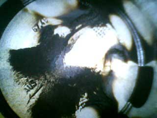

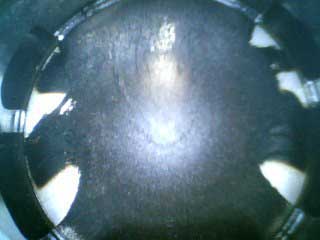

My pal Lance asked, “So… Do you wanna put the big piston in the front or the rear?”
I assumed he was kidding… He assumed I knew what I was doing… A train-wreck of assumptions. Deliberating shortly, we figured the larger piston would run hotter and should live closest to the fan.
After a couple of hours of swearing, doing-it-again, and fumbling around we got the thundering 447 back together… I’m sure we got most of those dang needle bearings back in the wristpins…
Back on the plane, the engine fired right up and ran strong… But the cylinder closest to the PTO (#2) was running a bit hotter than the cylinder closest to the alternator (#1). At 5,000 RPM and above, the temperature difference (both CHT and EGT) exceeded the difference allowed by the factory (36º CHT and 45º EGT). I have attached a spreadsheet that reflects the temperatures at different RPMs.
I got back to Lance and he said that he had not been kidding about two sizes of pistons… I was sick.
Purchased a dandy little bore-scope from Aircraft Spruce and with more swearing and fumbling about I could see what I have (done)…
Cylinder #1, Closest to the alternator, 67.46, green dot
Cylinder #2, Closest to the PTO, 67.45, red dot
Cylinder #2 is hotter… that shoots my theory about the bigger piston running hotter…
Also the top of piston #2 has accumulated a coating of carbon in only 5 hours of operation, while piston #1 is much cleaner. (Photos attached) I have run only AV-2 two-stroke oil in an effort to minimize carbon build up… I’m somewhat disappointed.
In reviewing the spreadsheet… It appears that each piston is operating within the temperature limits set by the factory for operation. The problem is the temperature difference between cylinder #1 and #2.
Before installing the digital engine monitor, I only knew the temperatures on one cylinder… I would have never have seen this problem and would probably be having a great time out flying, right now.
When Rotax sets limits for the difference of temperature allowable between cylinders, I’m pretty sure they are figuring on both pistons being the same size… (Krauts are like that…) A larger than normal temperature difference in an engine with matching pistons could indicate a problem… However, in an engine with different sized pistons, perhaps this temperature difference should simply be expected.
Comments?

This is the difference in size between your two pistons:
0.0004 inch
I doubt 4/10,000 inch will make a whole lot of difference. The 447 is not a watch. Austrian standards are not that tight on 447 engines. Most of the temp difference is probably difference in port size and shape, and other differences in air and fuel flow. They don't do a good job of matching them with the cast iron sleeves.
What are the difference in size of bore of the cylinders? Are they within 4/10,000 inch?
How accurate and repeatable is your instrumentation? I've seen Kolbers ruin their flying experience because they couldn't get a couple of Westach gauges to agree. Spent more time trying to get everything to match precisely than getting out there and having fun flying.
If it was mine, I'd take the warmer temps from the hotter cyl for operating limits, fly and enjoy.
I was told by an old time engine builder, that matched the ports and balanced my pistons, pins, and rings, on my 447's, "a little carbon is needed on the tops of the pistons to help lower operating temps of the piston." Carbon acts as an insulator.
BTW: I had good luck with my 447's. I had two, one on the Firestar and one on the bench ready to go. Balancing and matching ports made the 447 produce more power and reduced vibration.

Brother Voris:
Your temps, as shown in your nifty spread sheet, show deltas on both EGT and CHT which closely resemble mine, but
the overall range of yours, is a little cooler. My engine has had two green dot pistons installed about 130 hours ago and I just had it torn down and inspected last month out of suspicion that the crankcase seals were leaking. Nothing significant was found, although one wrist pin was replaced as an "option" since it displayed minor wear. Both con rod top ends and wrist pins showed some bluing which reflected the high temps for which the 447 is well known.
For what it's worth, the rear (PTO end) cylinder on mine has always run around 25 to 30 hotter on CHT and 40 to 60 degrees hotter on EGT. I worried about that for a while... played games with minor adjustments of the angle of the Bing on the manifold, repeatedly checking fan belt/shroud, tinkered with jetting and needle, etc. Finally decided
to hell with it and just flew it. The CHT's were in the 380 to 405 range at WOT and the EGT's ran 1040 to 1100
at 5800 cruise.
Since the teardown inspection, head temps and EGTs have jumped up and I can't figure out why. At WOT climb after about 45 seconds the rear cylinder is climbing through the red line at 425 and the front is right behind it at about 415... I have to throttle back and level off or they would continue to increase. The EGT's are also higher and now show 1100 and 1150 at 5,800 cruise with the heads hanging around 400. The plugs are both a nice brown color. I have run it a total of about three hours since the teardown am about ready to re-torque the heads.
Other than the new wrist pin and all of the gaskets and seals, nothing was changed in the engine. The work was done by an experienced, certified shop in which I have confidence. The jets and needle in the Bing are stock sizes and show no wear. The IVO is loaded to the same 6000 RPM static as before. I went so far as to replace all four of the EIS sensor probes to make sure they were giving accurate data... They are. I am baffled by the increased temps.
Overall, Henry, yours looks to be running cooler than mine. Personally, I would settle for your temps and just go fly it, watching the plug color for anything strange.
My engine, on the other hand, definitely has a newly developed higher temp problem which requires attention... In the absence of any better idea, I am going to start with further searches for leaks in the manifolds and then move into the Bing jetting and setting business...
If anyone on the List has experienced similar high temp fun & games with a 447 and successfully whipped the problem, (or blew/burned it up, but executed a successful autopsy) I would appreciate hearing from you.
