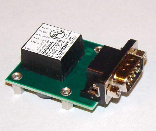

This is a good example of why this and similar discussions
need to be brought to this List. We've had many discussions
over the years concerning the system integration risks for
systems that perform as advertised at very attractive prices
but without the support of studies showing suitability to
task in airplanes. One good example is the popular LuxDrive
product for LED lighting.
[img]cid:7.1.0.9.0.20120113110033.01fa6820(at)aeroelectric.com.0[/img]
While it performed as advertised, it was a noise generator. I crafted
a repackaged product that made it easier to mount, easier to wire,
and added a filter for noise mitigation.
It strikes me that this HID ballast package might well benefit
from a similar repackaging effort.
